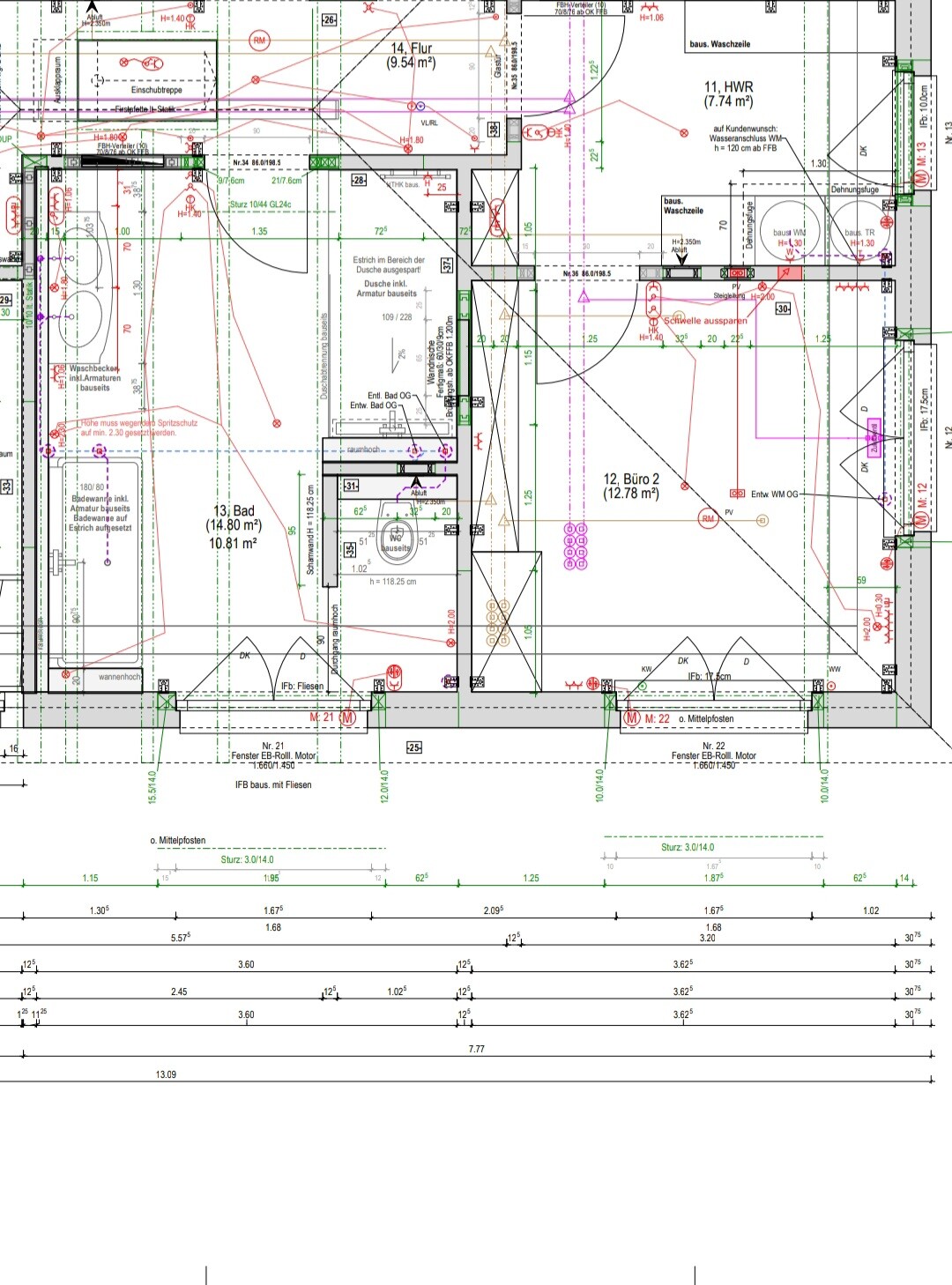

We are currently building a prefabricated house with a major manufacturer and are actually at the point where we should be informed about the installation date. This means all documents have already been finalized and approved, and according to the builder, no further changes are possible.
However, the builder has now unexpectedly contacted us to say that a circulation pipe is mandatory on the upper floor, as the 3-liter rule allegedly cannot be met. During the selection process, we already signed off that we do not want such a pipe.

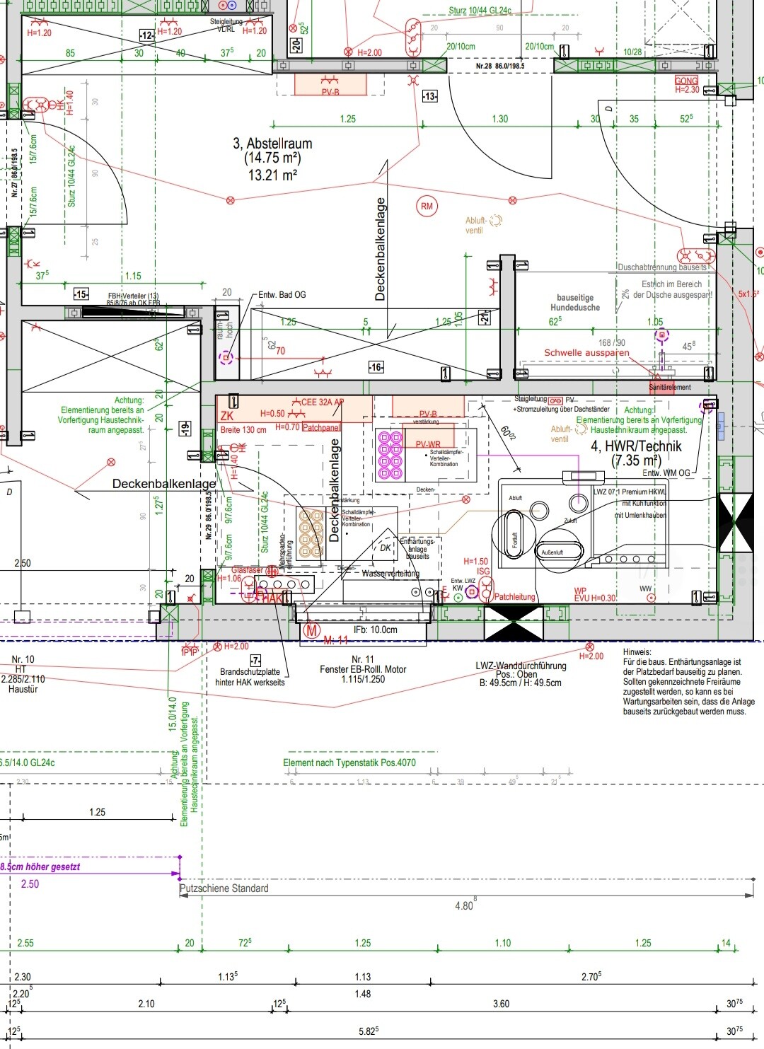

The bathroom on the upper floor is located almost directly above the utility room (a section of the floor plan is attached). Although I am not an expert, my own research suggests that a circulation pipe would be rather unusual with this pipe layout. We still do not want a circulation pipe.
We have already had problems with the builder, and the tone has always been “if you don’t agree to the extra costs, construction will stop.” We expect this again in this case.
Are there any experts here who can support us or give an assessment of whether a circulation pipe is really necessary?
Scash

Hi Nauer,
thank you for your reply.
It’s a bit unclear to us, as the distance to the bathroom on the upper floor is actually quite short. For a 16x2 pipe, you would need about 27 meters (89 feet) to reach those 3 liters.
We have requested the plans. However, we assume that the construction company will not provide them easily. That’s why we are now looking for some support 🙂
Scash
