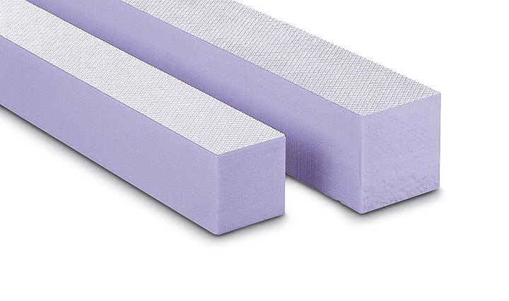

What speaks against filling the gap with perimeter insulation strips (extruded polystyrene boards)?
I bring this up because I still have plenty stored. In addition, foam seal every small opening and apply compressible sealing tape below the window.

24 Aug 2018 13:27
Basically nothing. Maybe the very poor sound insulation? To me, it seems somewhat unstable, even though I have often used extruded polystyrene (XPS).
