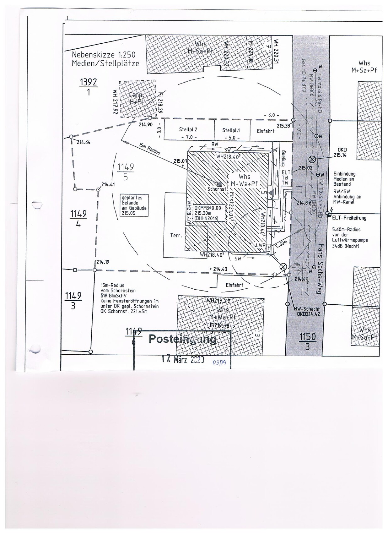

Attached are the drainage and site plans

We also built with Heinz von Heiden, and everything worked out well. A few comments on your plans and the points you mentioned:
Regarding your “trenching problem”:
You can run the wastewater pipes through the slab. This way, you only need one wastewater outlet, which saves you the excavation work for the wastewater pipes. A rainwater connection is located at the house connection point, so that’s not an issue either. For the rainwater connection at the top left, you would only need to excavate there, or you could install a cistern or infiltration chamber in the area of the left parking spot.
If you want to keep your external pipes, they can also be nicely installed inside as a DIY task during the construction phase (if you want to). The foundation cushion is basically “compacted sand” and extends about 1m (3 feet) all around larger than your floor plan. Within that meter, you can place the pipes accordingly.
- Why do you want to use L-blocks? If I’m reading the plan correctly, all three houses are at roughly the same elevation at street level, with only a few centimeters difference. You could also set the house a bit higher if needed.
- How do you arrive at 40m when the dimensions are 14m long and 10m wide?
