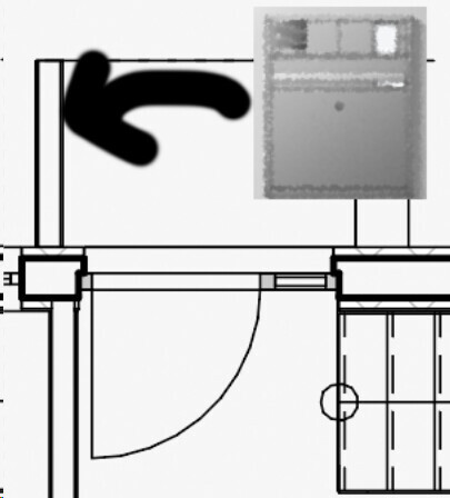

We are about to start building our single-family house.
In the wind protection wall in front of the front door, I would like to install a flush-mounted mailbox with an intercom system.
Specifically, I have selected a Siedle Vario system with the following components:
Bus door speaker module
2x blind module
Bus button module
Mailbox module with mail slot flap
This is how it should look.
2x blind module
Bus button module
