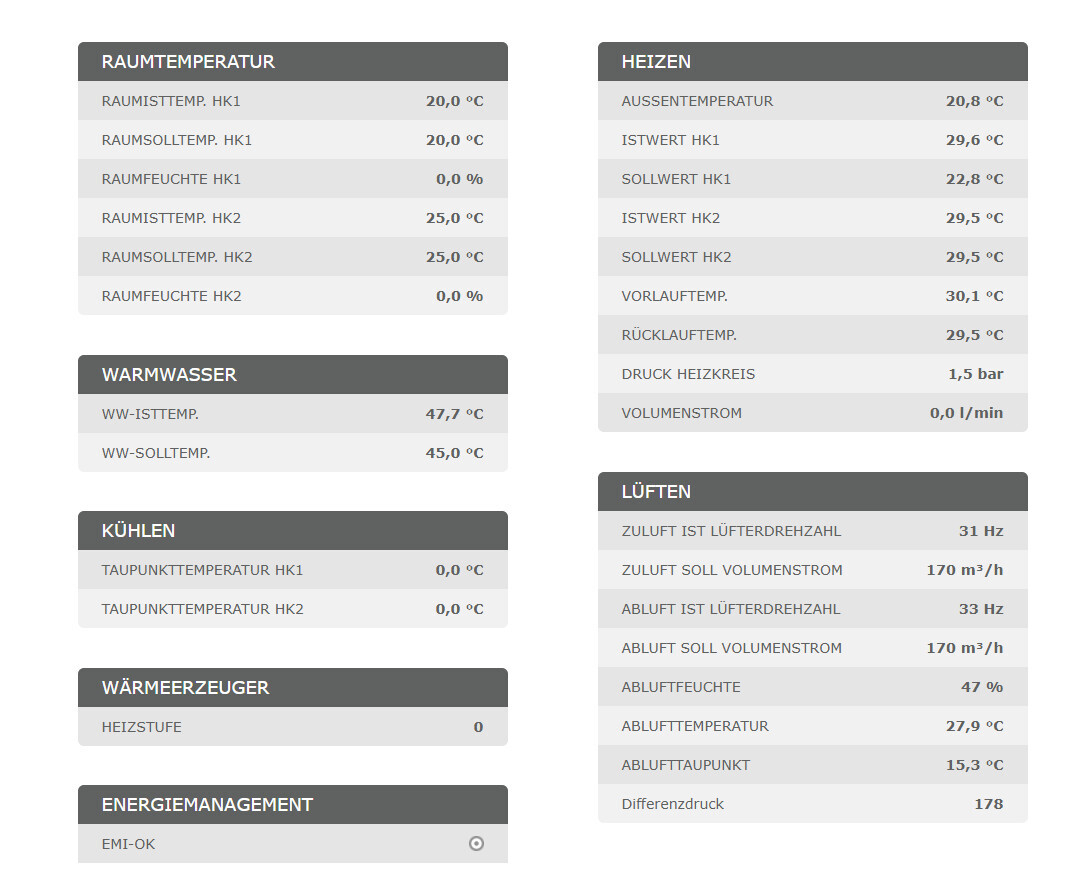

Our heating system (Tecalor THZ 504) has already decided, based on the outside temperature—which is currently around 20°C (68°F)—that it is in summer mode. In other words, the heating is turned off.
The system information still shows the flow temperature at just under 30°C (86°F), but the flow rate has dropped to zero.
The ventilation is still running, and I suspect our heat recovery unit is causing the issue—because what’s the point of exchanging indoor air with outside air if it blows the air back inside at almost the same warm temperature as it took out?
We only have an outdoor temperature sensor. The device doesn’t handle the indoor temperature very well. It claims the current indoor temperature is 20°C (68°F), but it seems to detect (through measuring) that the exhaust air temperature is about 28°C (82°F). This matches what our various thermometers around the house show.

Regarding the bypass, the question is whether one is installed or not. Since you have a compact unit, maybe there isn’t one. We have the THZ 504, which is probably identical to the Stiebel Eltron 504. Unfortunately, I don’t know if there’s a bypass installed; I’ll try to check and see if I can make sense of the technical terms. In the menu there’s both a "summer cassette" and a "bypass" setting. Doesn’t it make sense to have only one of those?

At the moment, that’s not really our problem because it’s still cooler outside than I want it inside. Our problem is that it’s 20°C (68°F) outside but 28°C (82°F) inside.
What I don’t quite understand is where the warm air keeps coming from. Yesterday we ran the air conditioning for the first time—it works, of course—but we had planned to use the AC only in summer, not from the first sunny day. Last night sleeping was comfortable, but this morning the bedroom was already a sauna again. Where is it coming from? Are we radiating that much heat? It wasn’t an issue in winter. The sun hasn’t shined at all yesterday or today. Where is the heat coming from? O.o

Where is the house located? Something doesn’t quite add up. For some, the heating was still running until two weeks ago (also new builds with ventilation systems), but you already have 28 degrees inside. What kind of “high-tech houses” do you have? The house is in northern Germany. It’s cool and rainy outside. It’s built to KFW55 standard. That’s why I’m wondering if something is off here or where the heat is coming from.

Try turning on passive cooling. Which setting would you recommend? I can select between “Off,” “Supply air,” “Extract air,” “Bypass,” and “Summer cassette.”

I think we really have to tackle this more seriously. But there must be a way to bypass the heat recovery on the ventilation system for summer. We will probably need to buy a summer cassette.
In the THZ 504, passive cooling is activated through ventilation. Further information MUST be provided to you by the plumber. However, make sure to have your system explained to you as thoroughly as possible and try to understand all the functions. Take detailed notes during this process.
