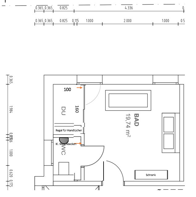

Does anyone have ideas for our bathroom design? We want to optimize it.
What must stay:
Shower and toilet (the depth will be increased to 1 m (3.3 ft))
Floor-to-ceiling window – the number and arrangement can be changed.
Everything else is adjustable:
Bathtub
Vanity with countertop basin
etc.
Any suggestions?
What must stay:
Bathtub
etc.
Any suggestions?

mrs_bauherrin4 Jul 2018 11:56Thank you, Matte,
I will pass this on to our mechanical ventilation system installer right away. Do you happen to have one from Zehnder as well?
Well, I think we will have a small washbasin installed in the toilet. That way, it doesn’t matter if the larger washbasins are a bit far from the toilet.

Since the walls of the toilet and shower are still going to be moved, the floor-to-ceiling window in the upper left corner will be removed in its current form. It will either need to be narrower or removed entirely. The dead corner in the upper right is also quite inconvenient.
Once the shower and toilet are fixed, the popular T layout could be completed. This would mean installing double doors as a window in the center, and the bathtub could be framed with furniture opposite it.
The bathroom door would need to be relocated. Since the hallway is not visible, I assume this should be possible.
Just showing some alternatives.
mrs_bauherrin4 Jul 2018 12:25Thank you, Katja,
that would be a very good idea; I could come around to the "widely popular" T-layout.
I’ve simply seen that one too often already, so I don’t like it anymore.
Also, the steam shower is a prefabricated unit – meaning the doors and such cannot be moved, and a T-layout would block the door.
The bathroom door should stay where it is.
I’ve attached an alternative; please forgive me – I made it quickly in Word.
Not much has changed... hmm
