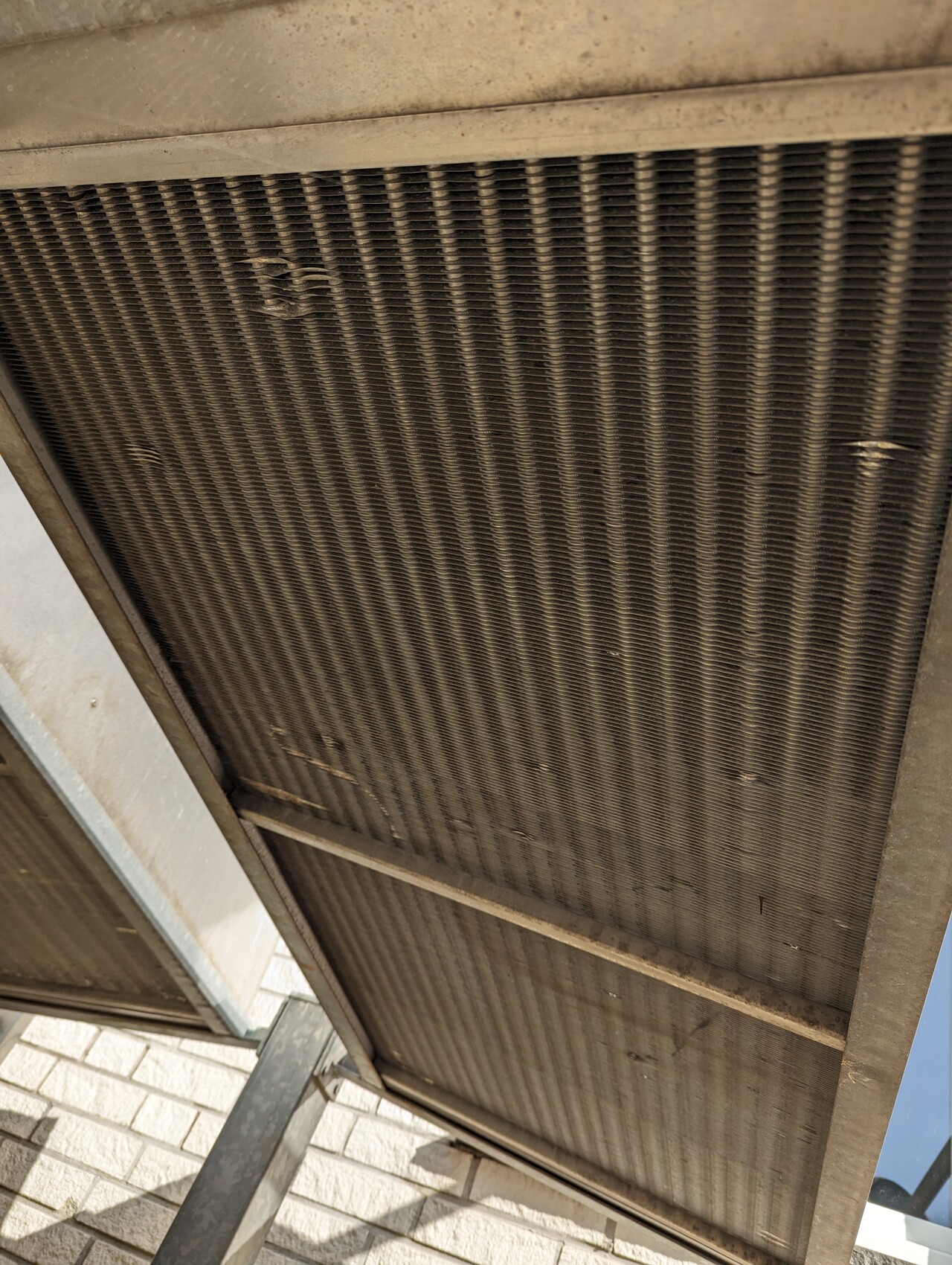

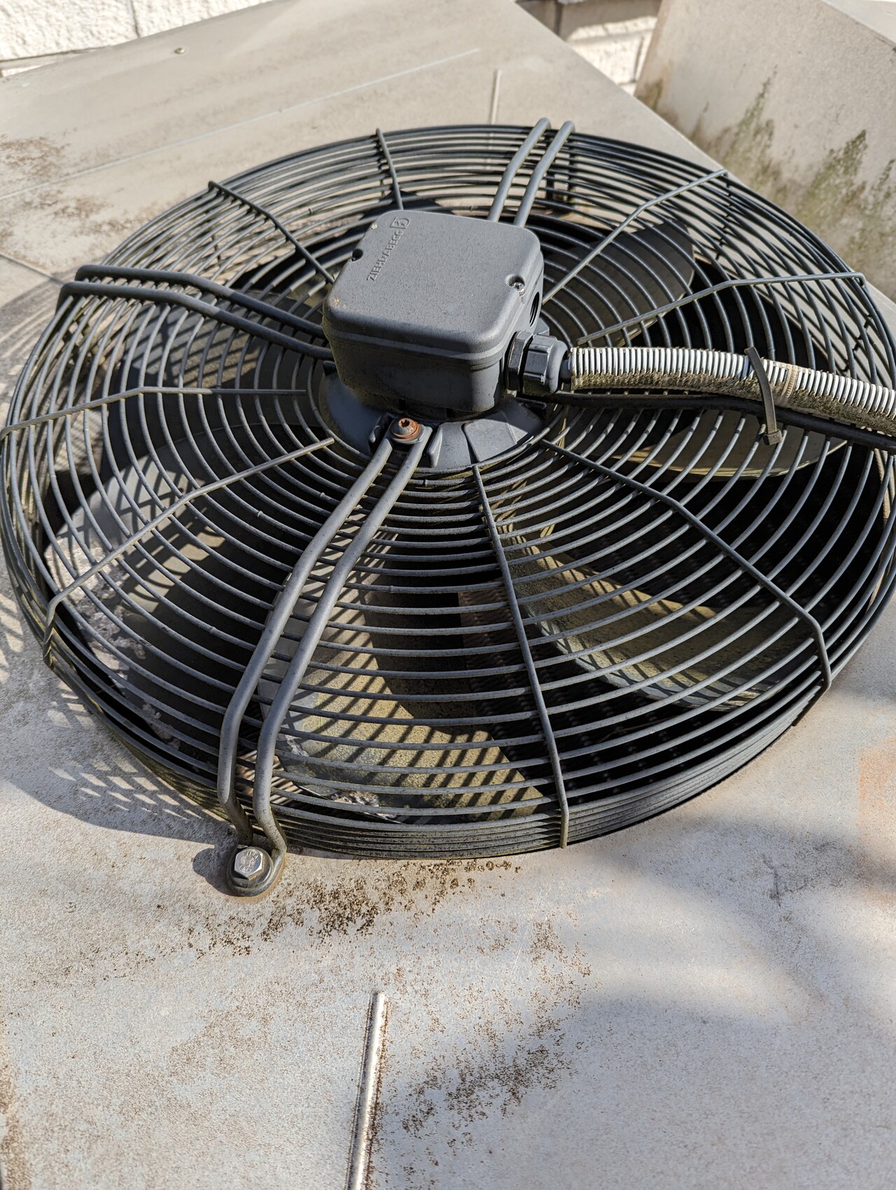

7 Oct 2023 13:41
This is what the evaporator looks like after 19 years without maintenance.
Close-up of a dusty air conditioning condenser with thin metal fins
Large round industrial fan with protective grille, motor housing, and cables on a concrete surface
