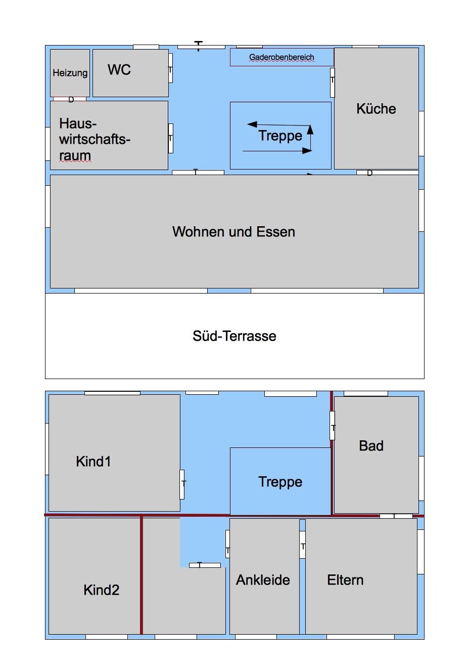

Traumhaus201318 Feb 2012 19:14Hello everyone,
A lot has happened today, unfortunately not all of it positive—more on that later!
@E.Curb: We had photographed the construction plans from some acquaintances. We are still nowhere near that stage; the plot does not belong to us yet, and we are still in the brainstorming phase.
However, we had another phone call and there was a huge misunderstanding regarding the price of such a house. We thought they meant INCLUDING the plot. Unfortunately, we had little knowledge at that point...
So, we sketched something ourselves and tried to incorporate ideas while adapting them to "our" location. For example, our southern view (we are on a small hill with a gentle slope) is almost divided in the middle (slightly shifted to the east) by the roof of a house. The access road (which is fairly quiet) is on the north side, and we would have to do some excavation. However, a few houses down the street, there are two houses without basements that have terraces on the natural ground level at the front.
That brings us to the next point. We are trying to manage without a basement. The dimensions are about 12.5 x 8 m (41 x 26 feet). Two full stories with a 20° roof pitch. One ridge line runs across, plus two large dormers that have their own ridge lines. The ridge lines are marked in red on the upper floor sketch (below), the ground floor is above. The staircase turns around the corner with a landing. Oh yes, the heating system takes up little space (geothermal heat pump), so I hope the utility room will be sufficient. Storage space might be available from a crawl space above the bathroom and an attic space over the double garage (located to the north but not directly attached to the house).
D = Opening
T = Door
Otherwise, you can see everything in the sketch!
For now, I have used a construction cost calculator based on the gross volume, but these are only approximate values.
As I said, it is a sketch, so there are no precise measurements. Details will be planned later with the architect.
But first, I am looking forward to your practical opinions!
Traumhaus2013
