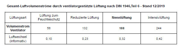

What is your room volume and what air exchange rate are you aiming for? The datasheet states a maximum airflow of 260 m³ (9,180 ft³). I would need to ask specifically 🙂 I will provide that later.
I keep coming back to the same question 😉
We have 579m³ (20,440 cubic feet) of air volume to be ventilated before factoring in furniture and other objects displacing air, targeting a household of 4 people.
For the heating load calculation, an air exchange rate of 0.3 was assumed. That would mean 173m³/h (102 cubic feet per minute). This is within the normal range of the 260 model, which can be set to a nominal airflow between 115-200m³/h (68-118 cubic feet per minute). If I calculate 30m³ (18 cubic feet) per person, the recoVAIR 260/4 should cover this easily.
A party mode on turbo with 260m³/h (153 cubic feet per minute) would result in a maximum air exchange rate of less than 0.5.
The 360/4 E can be set in the menu between 175-280m³/h (103-165 cubic feet per minute). This would mean a minimum air exchange rate of 0.3 with hardly any upper limit.
However, the noise levels are quite similar. Assuming the larger system runs at level 1 while the smaller one would need to run at level 2, both devices would be equally loud. The smaller unit has a maximum of 59dB, whereas the larger one can reach up to 66dB.

Am I missing something... I had it calculated after all.
I think the small system will probably be sufficient for me. However, I will tell the heating engineer that I don’t need the enthalpy heat exchanger. At first, I will likely get moisture out of the building, and then I can buy an enthalpy exchanger in advance and install it if it gets too dry in winter.
