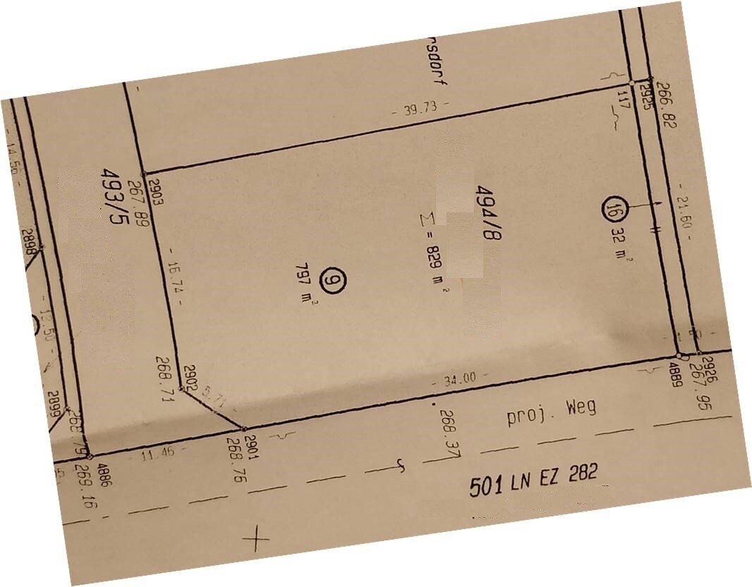

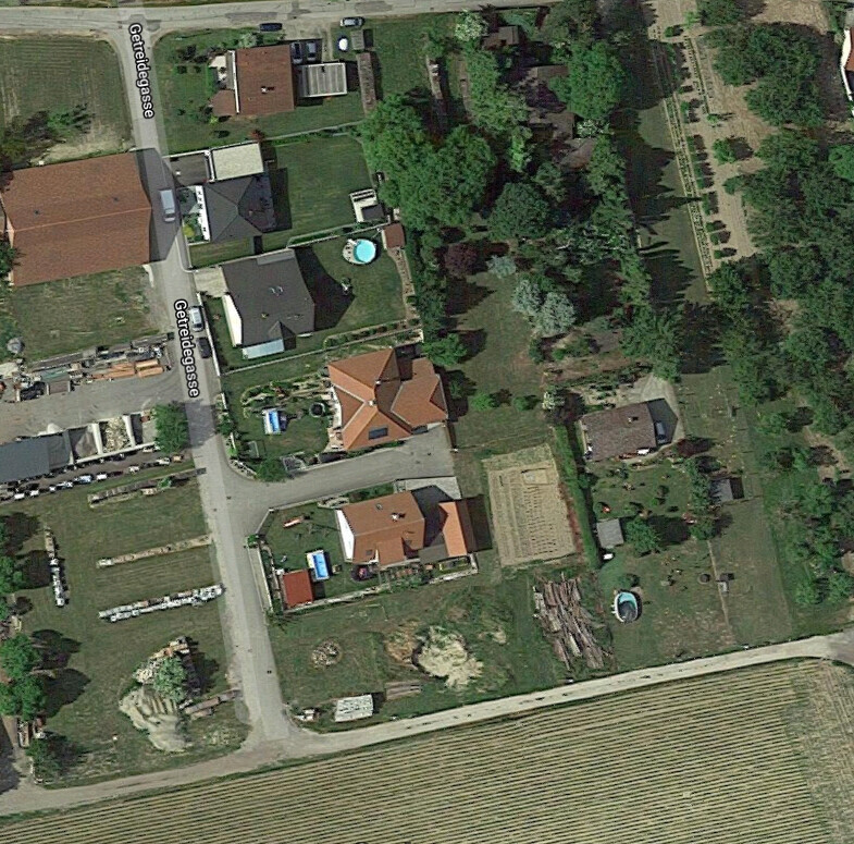

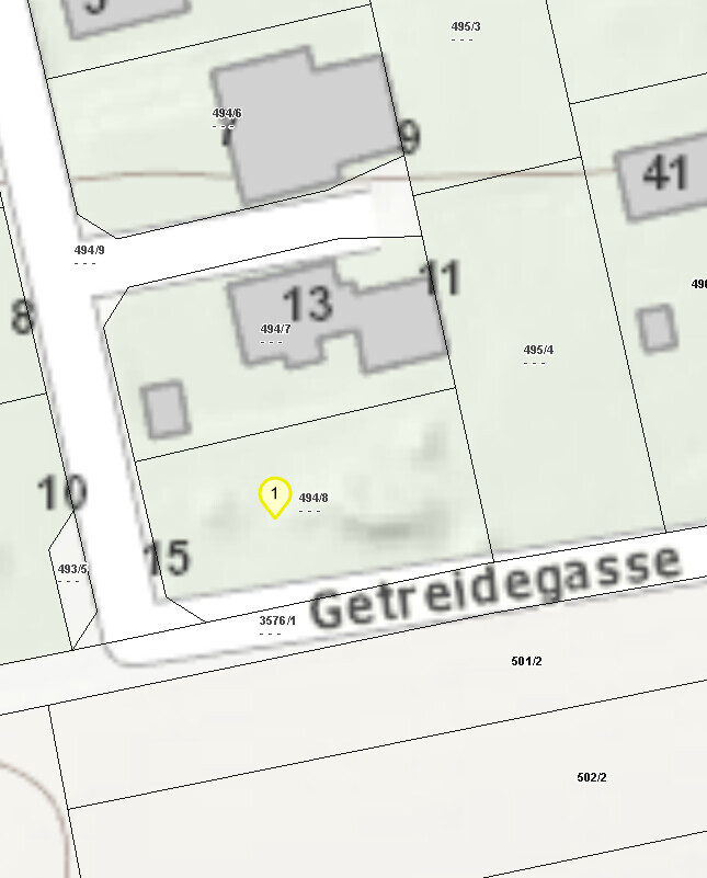

we are currently in the early stages of planning our house construction. We already own the plot of land – photos are attached – but we are unsure about the best way to position a house with a garage on it. By the way, the images are aligned exactly according to the cardinal directions.
Our plot is number 494/8 – the adjacent plot 495/4 belongs to relatives (though it is quite unlikely that they will build on it anytime soon), and across the street is farmland.
The house design is still undecided, but we currently lean towards two full stories without a basement. There should also be space for a garage (or carport).
If the house is placed on the west side, it blocks the afternoon sun in the garden. On the other hand, you wouldn’t want to block the morning sun from the east with a garage, especially if placed in the northeast or southeast area...
This might just be a luxury problem, but I’m still having difficulty visualizing the entire plot with driveway, house, and garage.
Do you have any tips or suggestions for us?
We are open to all ideas and thank you in advance!
I would plan the access from the street (not the driveway), placing the entrance and carport in the northwest corner, with the house behind it, rectangular but not square, and the house orientation parallel to the plot axis. The aerial view suggests it is unlikely to have two full stories.

DQuadrat schrieb:
There is practically no slope; the plot is relatively flat. I would be interested to know where you got your information from?Your plan shows elevation marks at the corner points. From these, there is a difference of almost 2 meters (6.6 feet).
WilderSueden25 Mar 2022 15:12DQuadrat schrieb:
There really isn’t much slope; the plot is relatively flat. I’d be curious to know where you got your information from? The third plan shows the elevations at each corner. I didn’t notice it at first either 😉
2 meters (6.6 feet) over that distance really isn’t much and is barely noticeable by eye. It’s the same with our 2 meters (6.6 feet) over an approximately 29 x 23 m (95 x 75 feet) plot. I was a bit surprised when the official site plan with the elevation profile arrived for the first time :/
