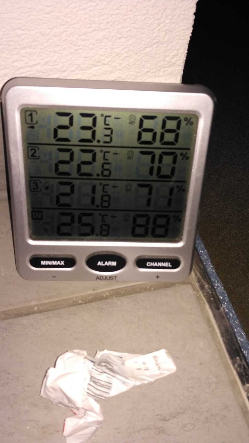

The photo is about 5 days old now, but on that day our screed was poured in the garage with the utility room door open, which provides direct access to the garage (needed for water supply to the screed, etc.).
In the rest of the house on that day, the temperatures were still only:
Attic 23.3°C (74°F)
Upper floor 22.6°C (73°F)
Ground floor 21.8°C (71°F)
Garage at that moment 25.8°C (78°F) with around 90% humidity (screed still fresh)
