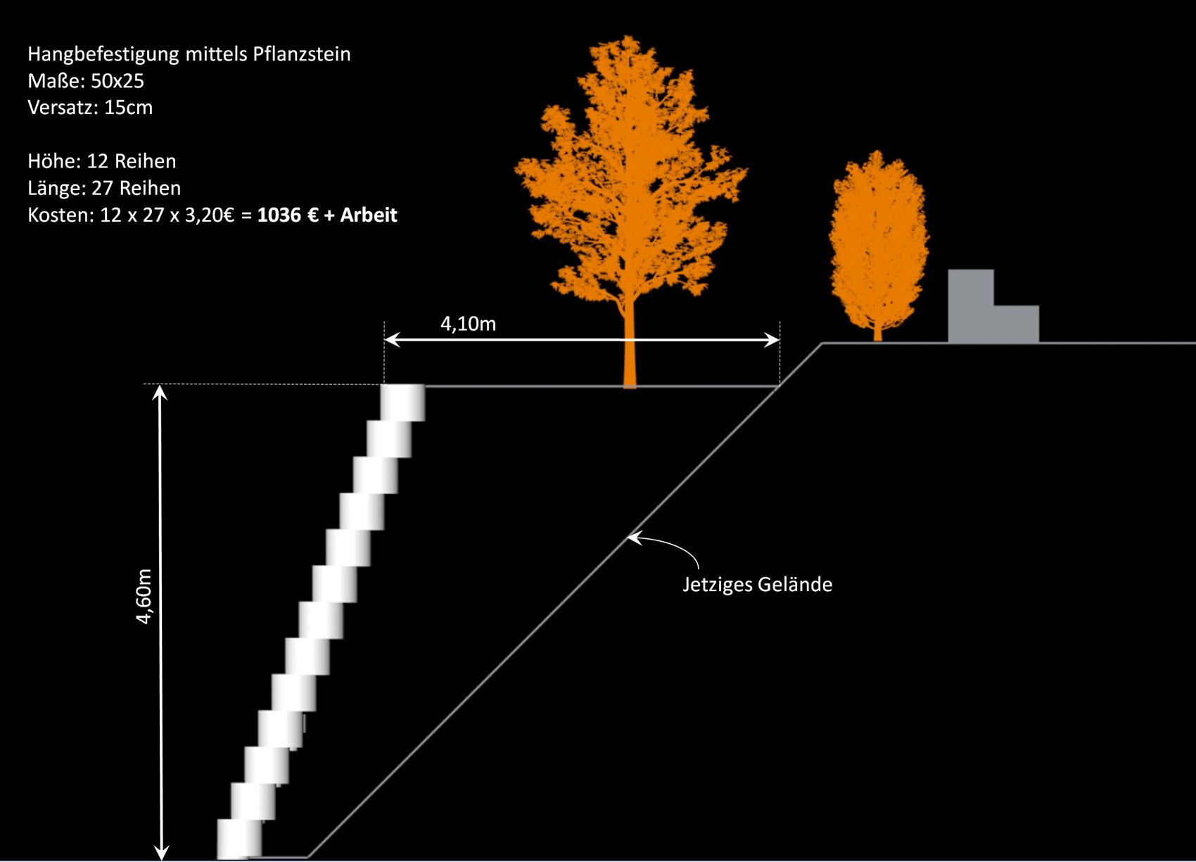

I want to stabilize the slope on my property (27m long) to create a usable, additional level.
My current plan is to stabilize only about 10m of it, since that area is the most important to have level.
This would give me a nice flat area about 4.1m long (13.5 feet).
I am looking for the most cost-effective solution for a steep embankment.
See the picture:
Someone told me that using old tires is the cheapest option and then planting ground cover on top.
But somehow I find that a bit odd.
What do you think?
Thanks!

nordanney21 Feb 2021 20:12Lüftung_KWL_ schrieb:
Someone told me old car tires would be the cheapest option, and then just put ground cover plants in between.For an even slope, you would need tires of the same size; otherwise, it will turn into a patchwork wall. Clearly, the tires would only cost 50-100€ (about 55-110 USD). But the cost of the entire slope collapsing, since the tires probably won’t hold, is not worth it ;-)With the incline you’re considering, I would only trust concrete and steel in the planter blocks… if at all. A solid concrete foundation, then stacking the blocks in rows and pouring concrete. However, you also need to make sure to include proper drainage.
How much further does the terrain extend? It might actually be simpler to just shift the current slope by about 4.10 m (13.5 feet). This way, you would only need excavation material. You can usually get that for free if you look around a bit. The top layers you would then purchase directly from the landfill.
A 4.5 m (15 feet) "wall" is definitely no small matter.
