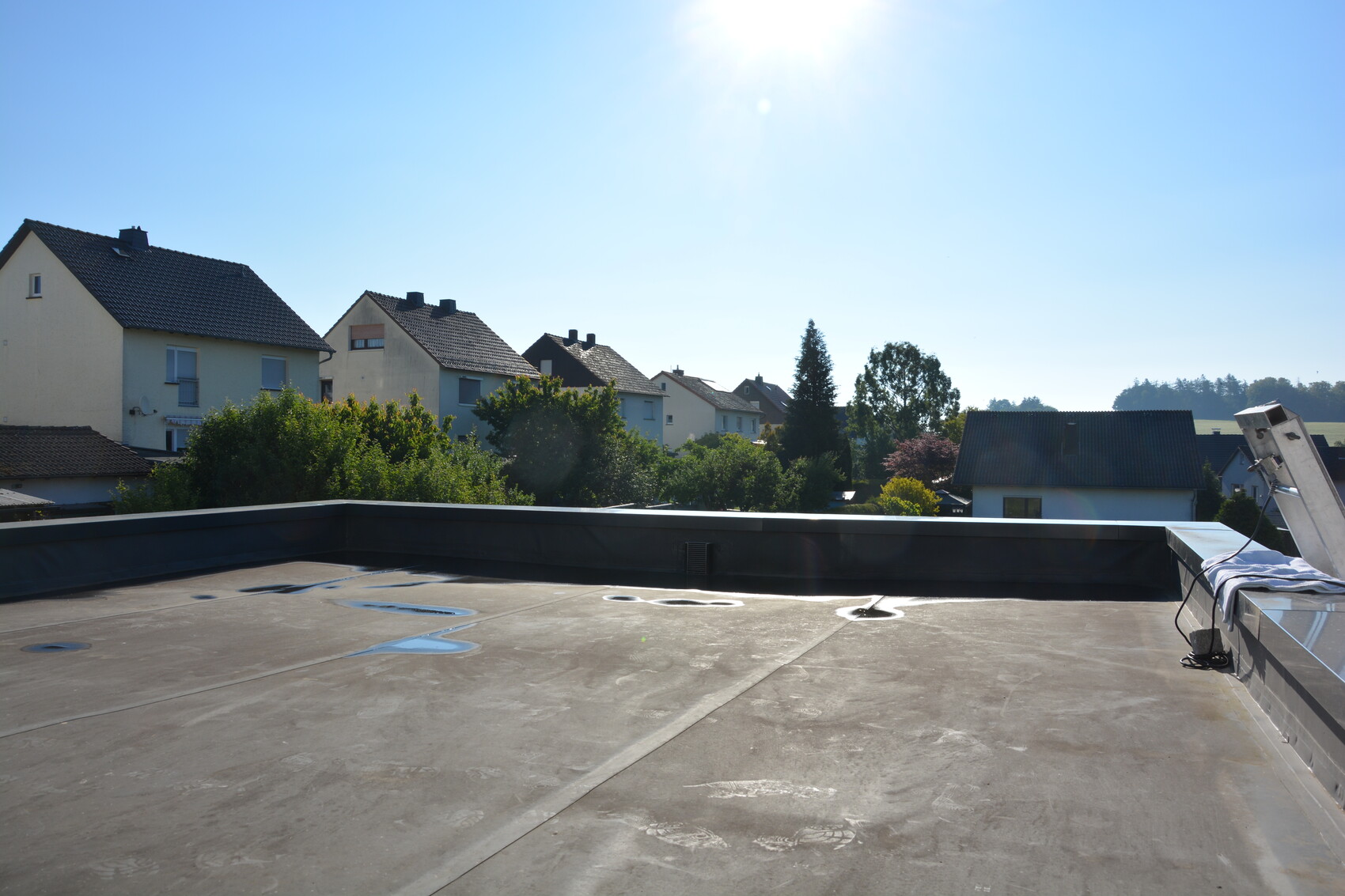

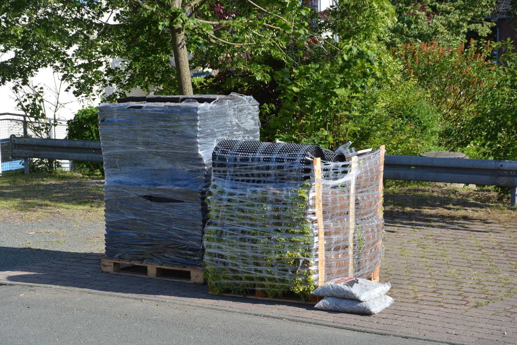

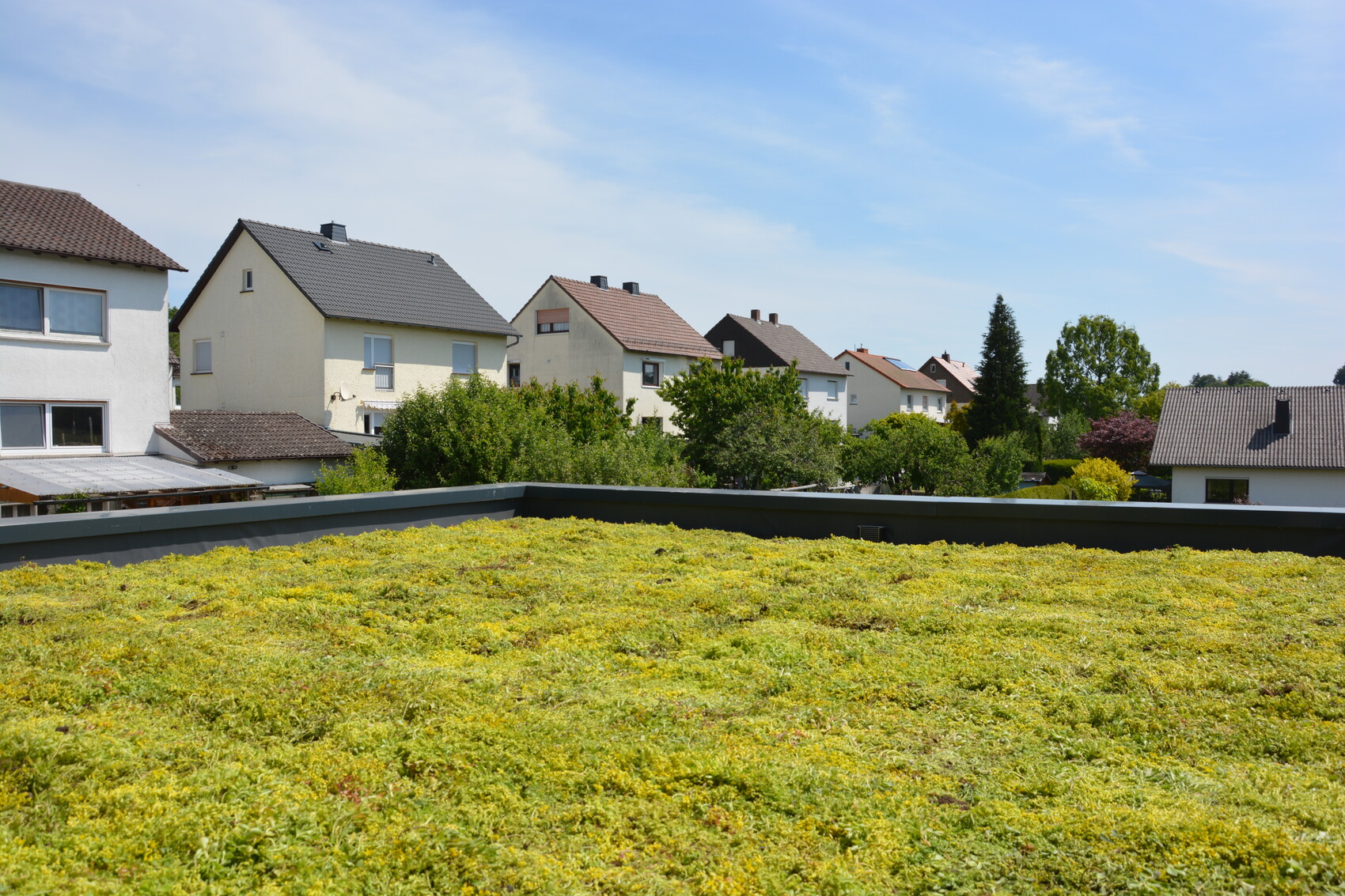

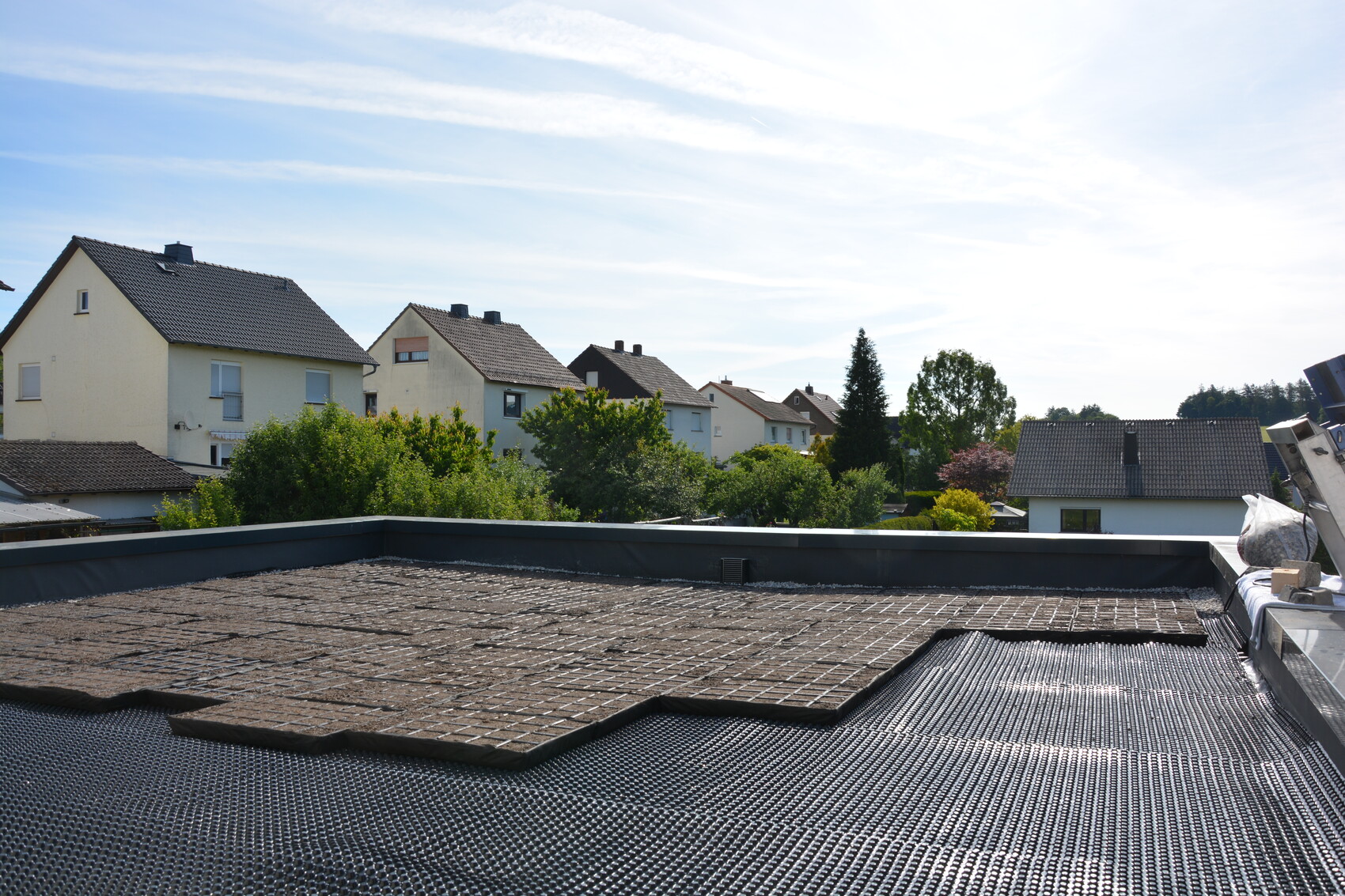

Do I need to consider any specific load capacity? Does the roof need to be prepared for this, or can I just install it directly on our flat roof, like you did? Thanks for any advice. Whether you can install directly on the existing roof depends on the waterproofing. It works with a membrane roof. For roofing felt, an additional membrane layer is needed.
Regarding the load capacity, it’s helpful to check the structural calculations or consult a structural engineer. The manufacturer will specify the weight of the green roof per square meter. You also need to add the weight of retained rainwater, which can significantly increase the total load. For my green roof, I assumed a maximum of 150 kg/m² (31 lbs/sq ft). Since my roof has a concrete slab beneath the membrane and insulation, this was not an issue.
