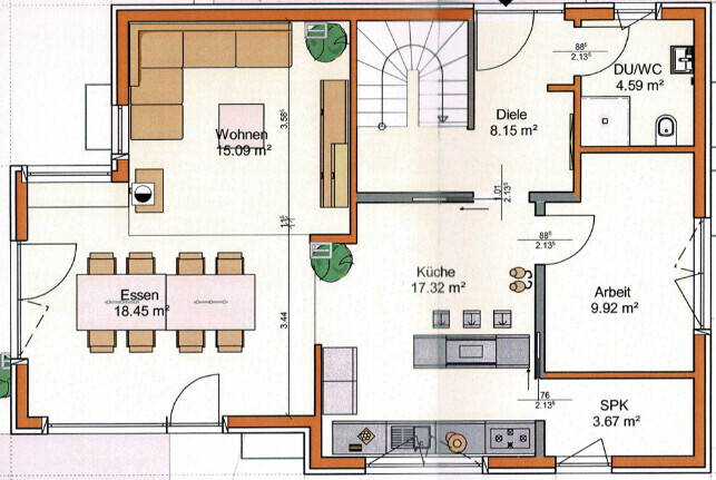

Attached is our ground floor plan. The stairs on the right lead down to the basement.
Does anyone here know more about this?
Thank you very much!

For tax purposes, the apartment must be rented out. You can only deduct acquisition costs, interest, construction expenses, landscaping, removal of soil, etc. (including both labor and materials) from your taxes if the apartment is actually rented at market rates, or if you can prove your efforts to rent it, for example by invoices for ads in a newspaper... that’s one point.
For the KFW funding, you ABSOLUTELY need a separate, independent entrance—so a private staircase. The apartment must have everything a typical apartment has: kitchen, shower, toilet, heating, a real front door, appropriate ceiling height, proper daylight illumination—therefore also powerful lifting systems with grinders. A second emergency exit. Another parking space must be documented.
The wall between the basement and the granny flat must be fire-resistant, including pipe penetrations, and smoke-tight. Additionally, the construction company did extra work here using high-density sand-lime bricks, and the wall is also thicker. We don’t hear his washing machine, and he doesn’t hear ours.

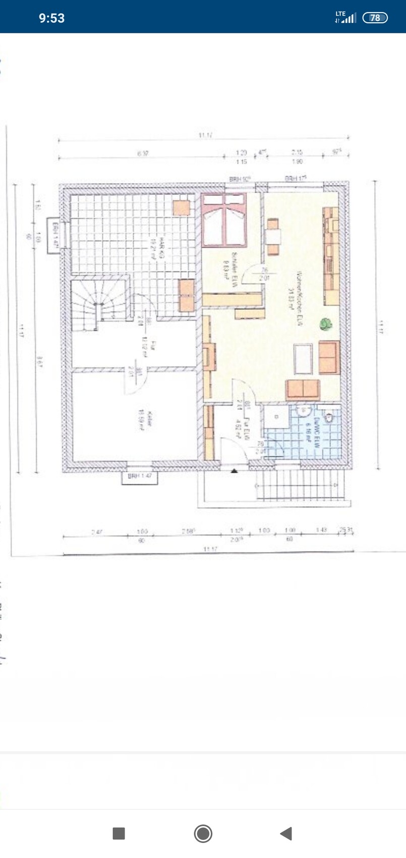

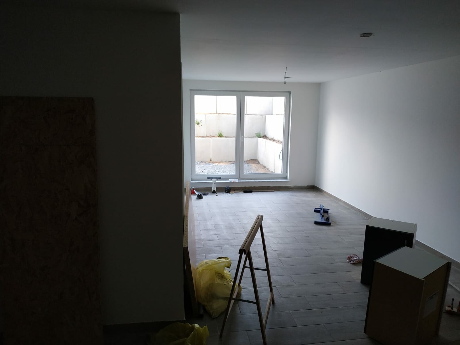

allstar8314 Jan 2020 08:40fragg schrieb:
If you have any questions regarding the floor plan and natural light, I can also share a picture. Thank you very much for the information. A picture of the floor plan and lighting would be really helpful.
This is a small 10m² (108 sq ft) south-facing terrace for the tenant, where they planted tomatoes and herbs this year. I watered them with a soaker hose. The window on the right is the bedroom, the one on the left is a large door to the living room. The kitchen is located at the back in the darker corner, and the bathroom has daylight coming from the staircase of the basement apartment.
On the floor plan to the left are our basement, my room, the utility room, and the hallway. Since there are only light wells, that is sufficient.
