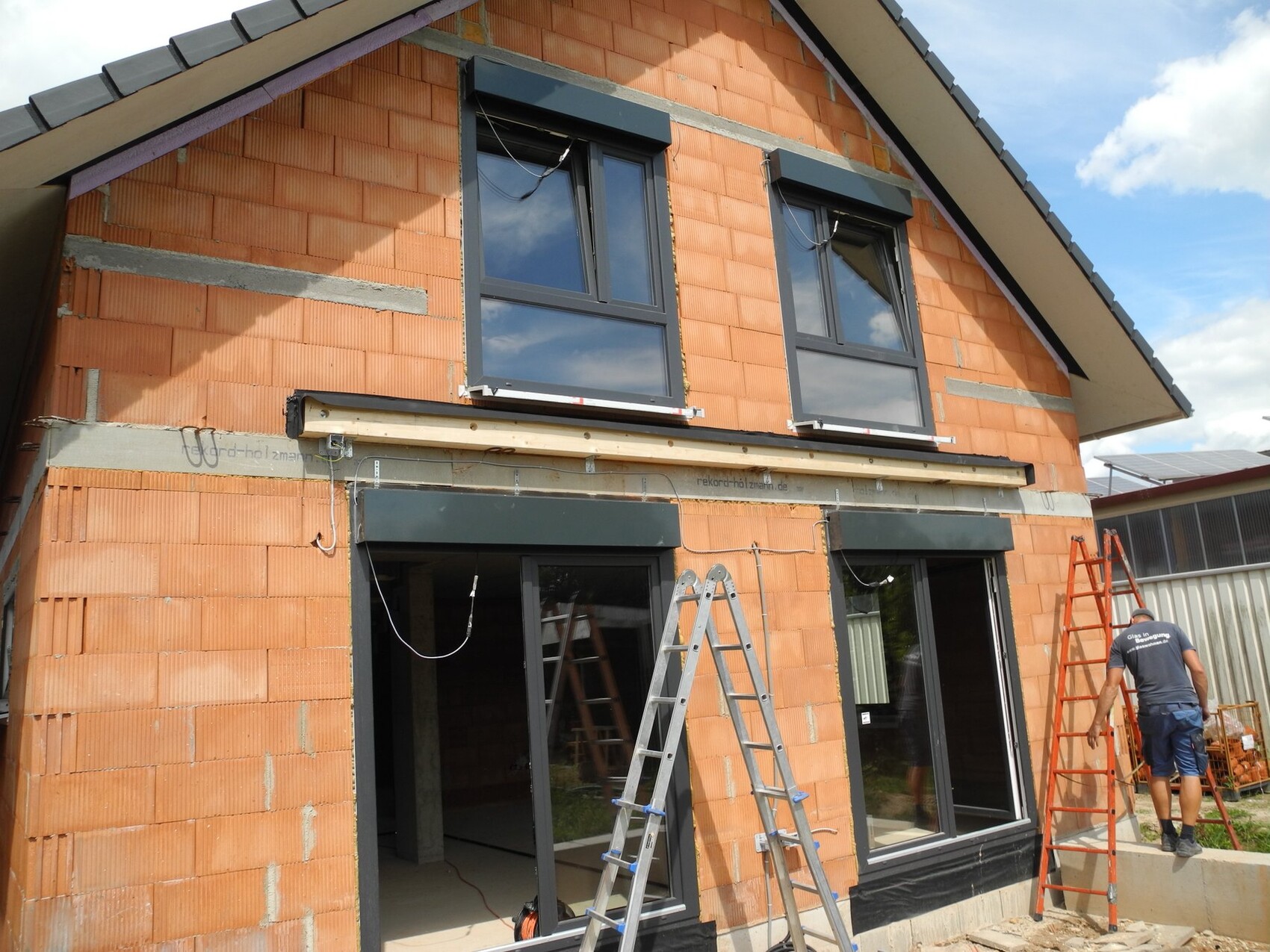

Deliverer11 Jun 2022 16:28You can see the beam here. Some waterproofing seems to have been applied. No additional insulation was added. The insulating effect of wood is certainly much lower than that of an external thermal insulation composite system (ETICS) – but it is still better than nothing. So far (six years), there have been no noticeable issues inside. On the outside, there is a conservatory in front of it.
I’m not sure how professional this is.
