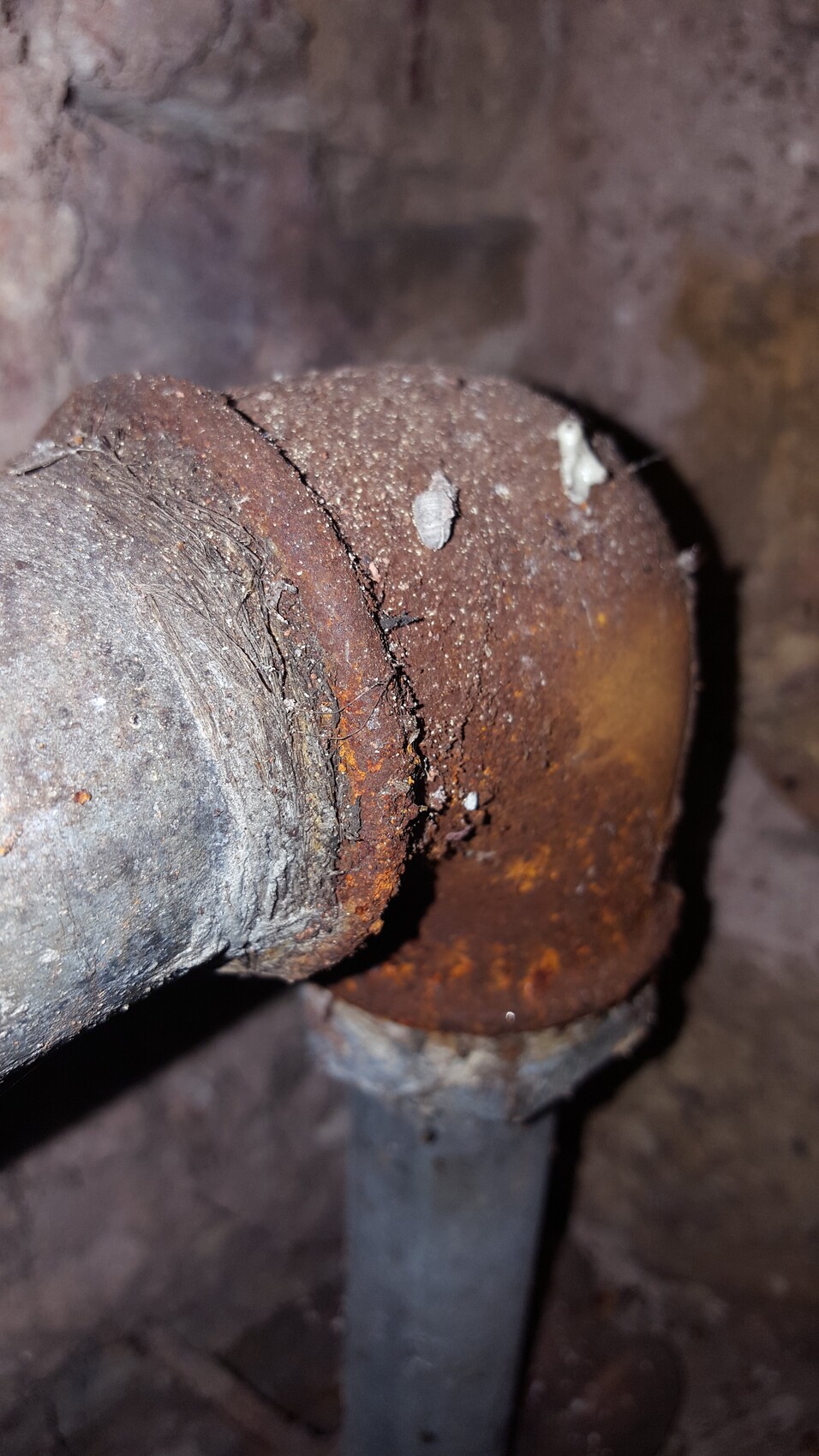

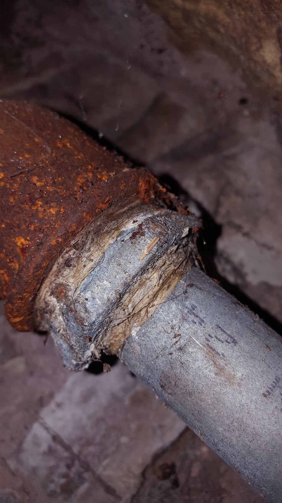

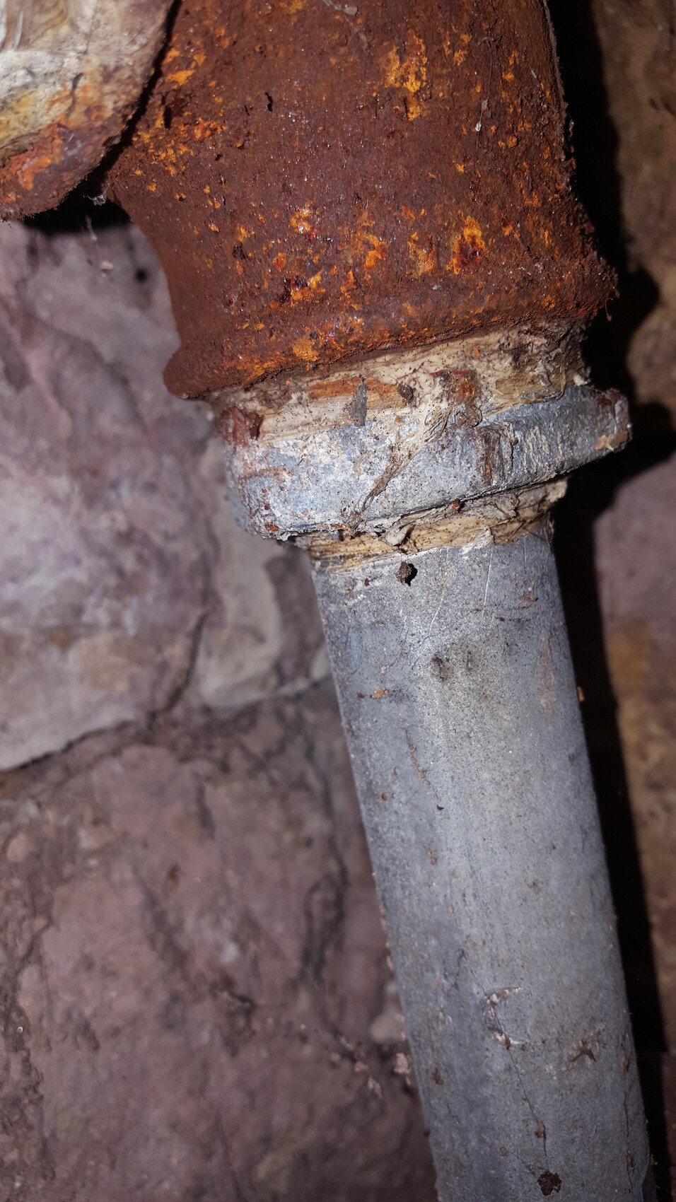

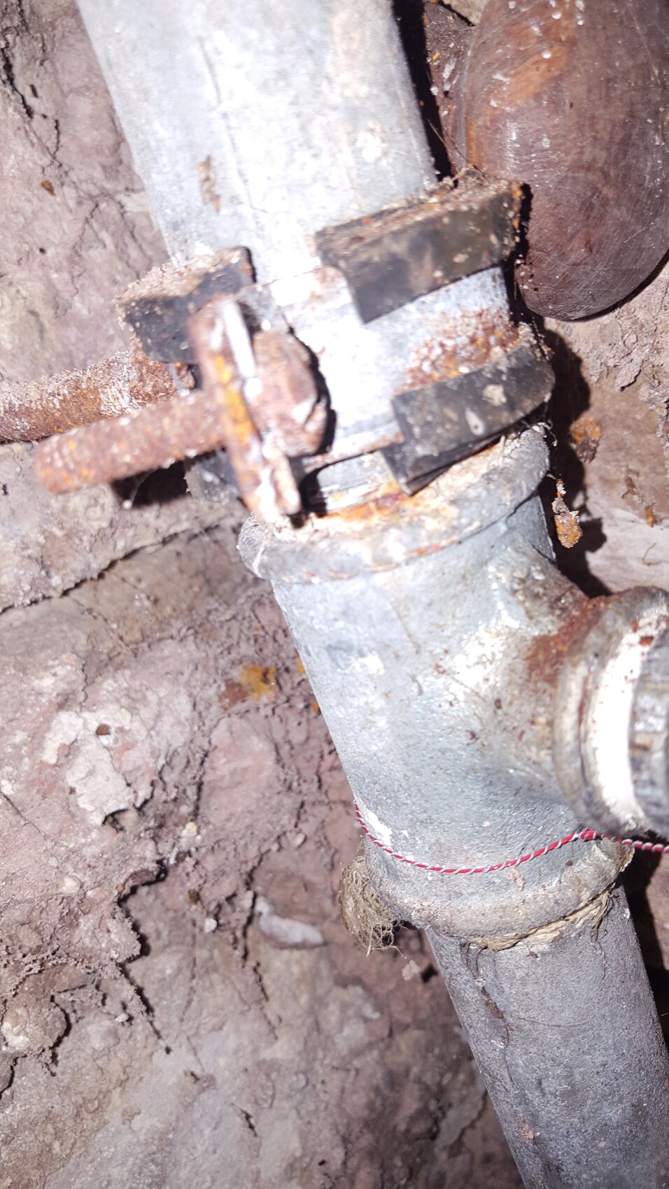

In my opinion, definitely yes. The pipe, elbows, and fittings look very worn out and, in my view, must be replaced immediately. The hemp joints also no longer appear reliable.

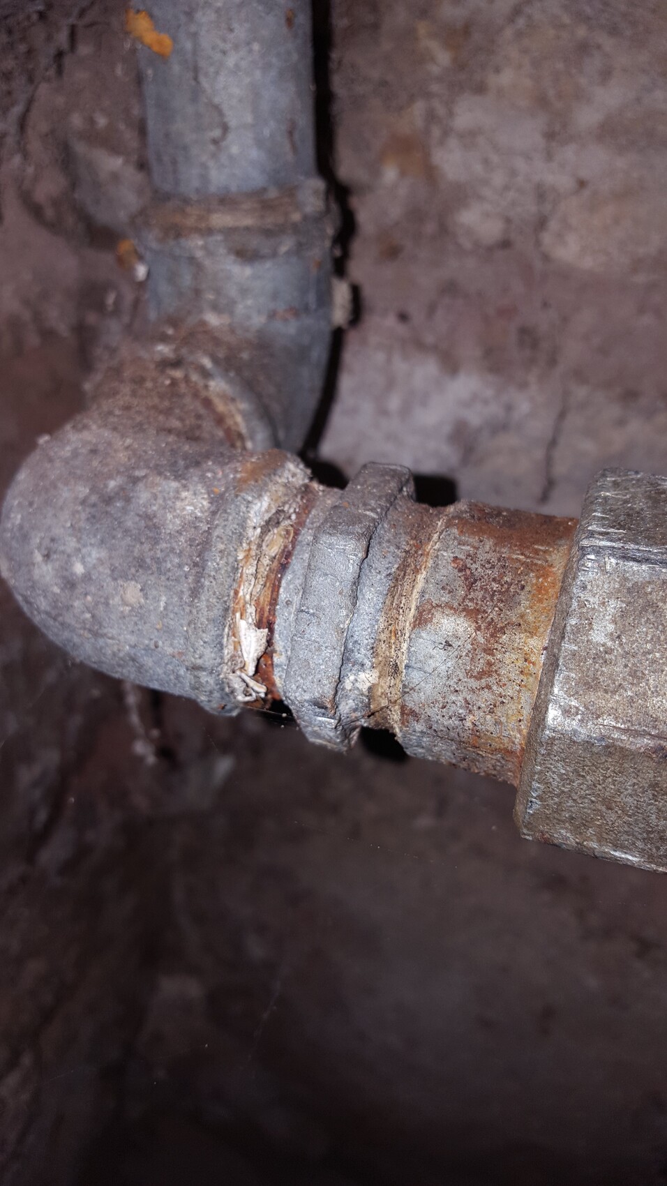

In the last photo, if I’m not mistaken, there is a threaded connection visible; this too is located in accessible areas and, according to the generally accepted rules of technology (a.a.R.d.T), is no longer permitted.
So please have a certified gas professional inspect and replace the piping immediately!
If you smell gas, turn off the gas valve right away, avoid any open flames, switches, or lights, and ventilate the area!

chriz081527 Feb 2019 20:55... I don’t understand how someone can approve such a condition of the pipe without recommending its replacement, but okay.
A good installer will replace the pipe and also update all other elements to current standards. Just replacing a single section to restore tightness would be too risky for me given the condition...
The fitting must be removed if it is freely accessible to third parties.
*In a modern, up-to-date gas system, a freely accessible fitting—even in a single-family house—should not be allowed in my opinion!*
Regards, Chriz
Regards, Chriz
