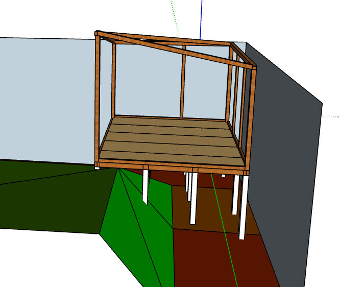

So the idea came up to build a garden shed in the corner, mostly on stilts, so it can be accessed at ground level from the garden side. If I read correctly here, the average height only counts the wall height up to the eaves. Or is that only for garages? If the roof height is counted as one-third, it should also be possible—for example, if that is 600mm (24 inches), the eave height would need to be under 2,800mm (9.2 ft). Or is the roof height above garden level included in the average roof height in this case?
One could place a garden shed in the corner starting at 1.1m (3.6 ft) and with wall heights of about 1.8m (5.9 ft) on the south and west, resulting in about 2.9m (9.5 ft) above ground level. On the northeast side, a diagonal rafter slopes so the eave is not too low on the garden side.
Now the question for the experts: Is this basically possible? (Aside from the effort and sensibility of the work). I have attached two views from the east and north for illustration. Or does anyone have an idea how to make it easier? The shed could also be extended in either direction, so the entrance would not have to be at the corner.

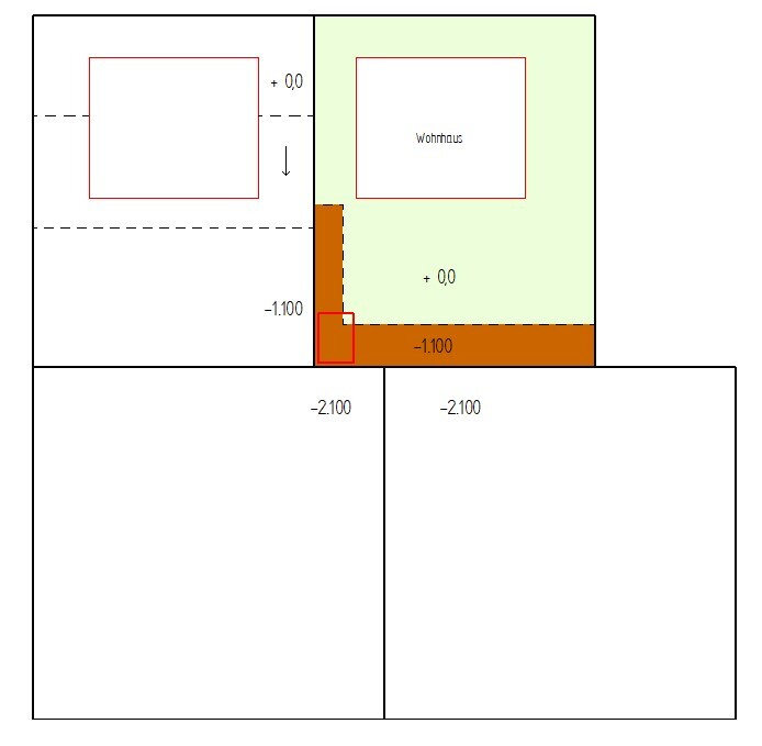

Christian_p27 May 2024 11:58Hello everyone,
Thank you very much for your support.
I have created a sketch as a site plan.
Our plot is the one in the top right. The house and most of the garden are on level 0 (green).
Parts of the west side as well as the entire south side form a slope down to level -1,100 mm (-43 inches).
The neighbor to the west has a gradient on their property between level 0 and level -1,100 mm (-43 inches).
Both neighbors to the south have level -2,100 mm (-83 inches), and each has a retaining wall on their property.
The garden shed is marked in red, in the southwest corner.

What is now interesting is whether it is possible to estimate how the garden shed will behave under the above conditions without further expert assessment. If I take the lowest point on the property as a worst-case scenario and go up 3 m (10 feet), it should fit. But how does it behave with the higher side? Does the ground level on which the wall stands apply?
