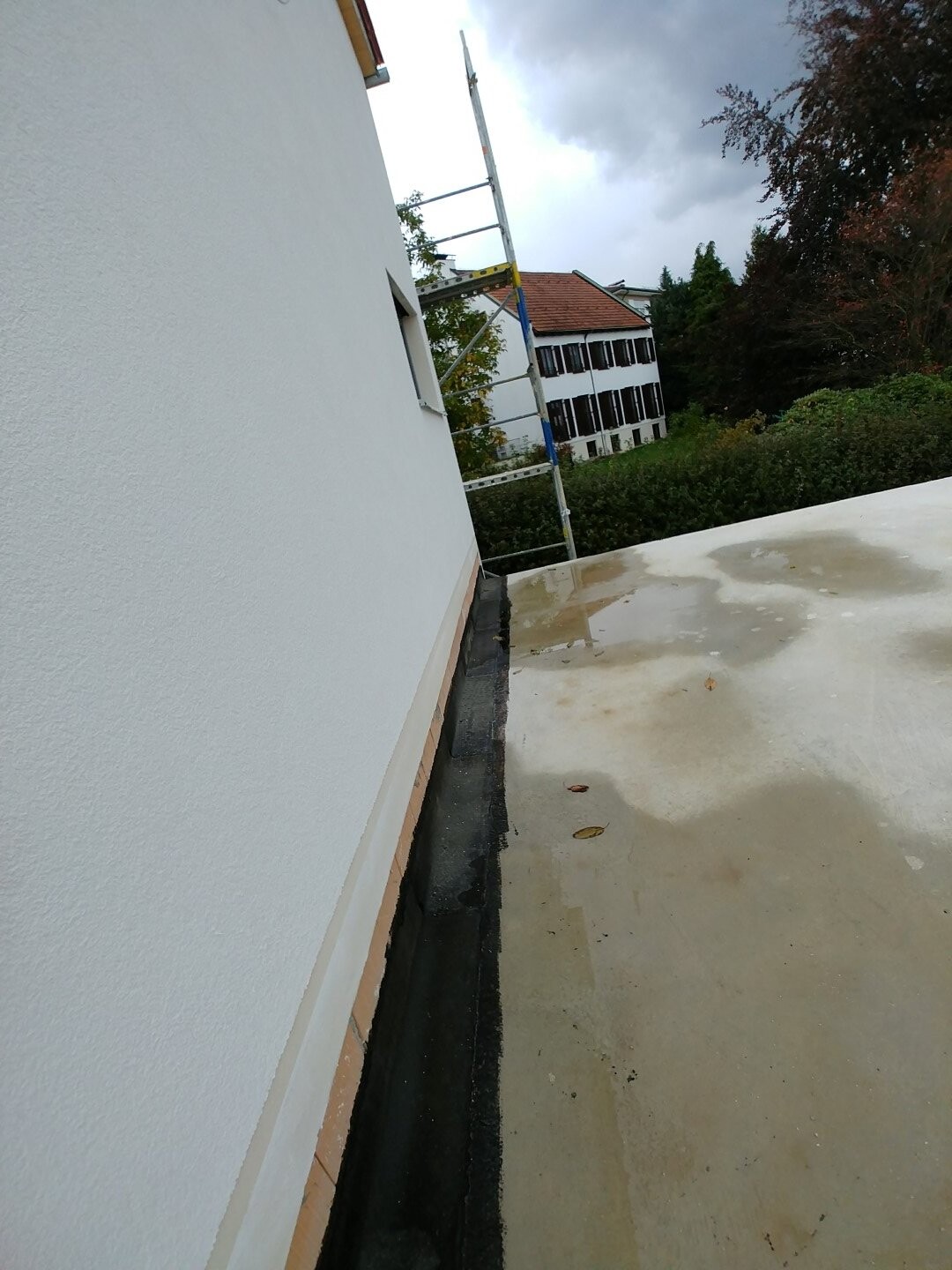

Marchonisch6 Oct 2017 11:55Photo 1 (77) is indoors, the other shows the exterior.
How was the gap between the existing building (garage) and the new construction sealed from above?
This is a really sensitive area.
We also had difficulties at that point (our concrete carport is adjacent on one side to the house’s masonry), and it only worked well when the temporary seal was applied onto the carport roof (flat roof). This seal was also extended partway up the house wall. Attached are some pictures showing how we solved it.
I can’t provide long-term test results yet, but since this was done, no water has come in.
In your photo showing the outside, you can also see how the water runs down here.
Sorry, I missed the photo. It looks like water ran down the outside of the wall. It doesn't really surprise me that it found its way inside in the "raw state" of the wall (without plaster and base waterproofing). However, the overall situation is not visible. Was there possibly a puddle outside in the corner (near the cables)?
