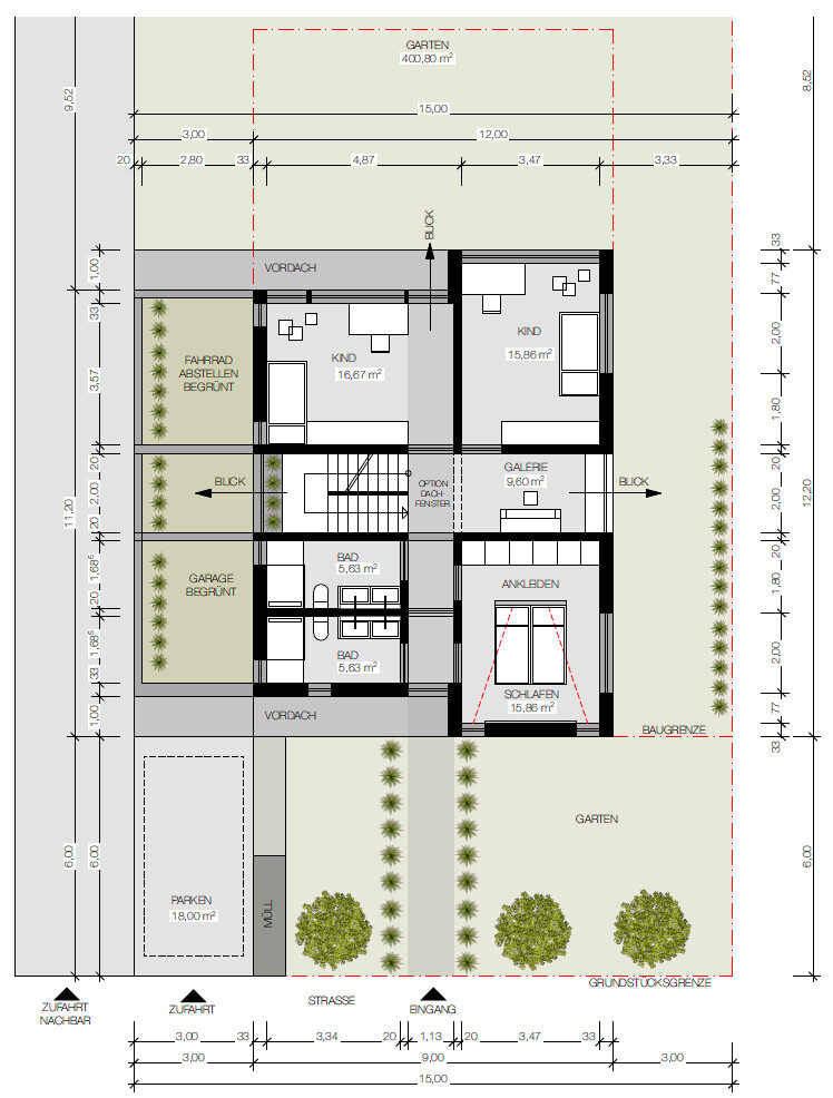

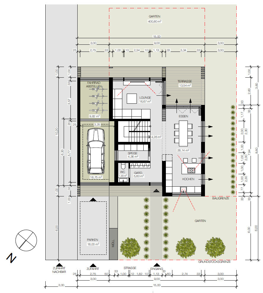

Until now, I have only been reading along, but now that our building project is becoming more concrete, this is my first post. I am looking for ideas, especially for the layout of the upper floor of our house. So far, neither we nor the architect are 100% satisfied with the ideas. That’s why I’m turning to you now.

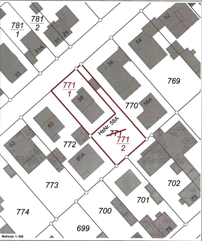

The plot we are building on was inherited and divided among the heirs. We want to demolish the existing building on plot 771/1 and rebuild. According to the development plan, only 25% of the area can be built on. Currently, there are no plans for construction on plot 771/2.

Plot size: 401m² (approximately 4,317 sq ft)

How can the master bedroom and bathroom be best designed? The architect’s idea is a hallway between the bathrooms and bedroom. With all doors open there would be a light axis through the house. That is not very important to us. We could also imagine the doors opposite the children’s rooms’ entrances. But then it becomes difficult to find space for the wardrobe.

- We don’t prioritize large bathrooms; minimum space is sufficient
- We spend a lot of time in the kitchen and have a lot of equipment, so we need plenty of storage
- Living/dining area can be extended outdoors in summer
- Home office in a quiet area
- If possible, master bathroom ensuite
Planner: architect
- Open living/dining area; from the kitchen you can see everything (front of the house and into the garden)
- Good use of the limited space (only 0.25 floor space index) from our perspective

- Access to children’s bathroom / master bedroom and bathroom

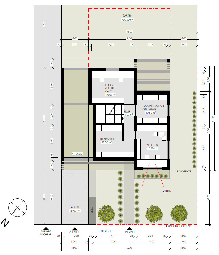

What if you move the guest room or office to the upper floor and put the bedroom and shower bathroom in the basement?That would definitely be an option. The idea of placing the office in the basement came from my preference for a quieter environment while working. Since I work 100% from home (even post-COVID), this is very important to me. If the office were on the upper floor—near the children’s rooms—that quietness wouldn’t always be guaranteed. There is still the extra room; I’ll think about how that could be arranged.
Personally, I would not put the bedroom in the basement with small children. There is a whole floor in between, and child 1 is only 3 months old, while child 2 is not yet born. This means many years of going up and down the stairs at night, especially on the days when they are sick.
vonBYnachSH schrieb:
An entire floor between, and child 1 is only 3 months old, child 2 not yet born.Well, you don’t usually build a separate shower room for an unborn baby and an infant. As long as child 2 isn’t here yet, there are still two rooms free upstairs – just because they’re labeled for child 2 and hobby/office doesn’t mean they’re unlivable. A floor plan always shows the optimal use for four individual personalities in a family, and since the family is still growing, not finalized but in progress, you can certainly use the rooms differently, right?Similar topics
