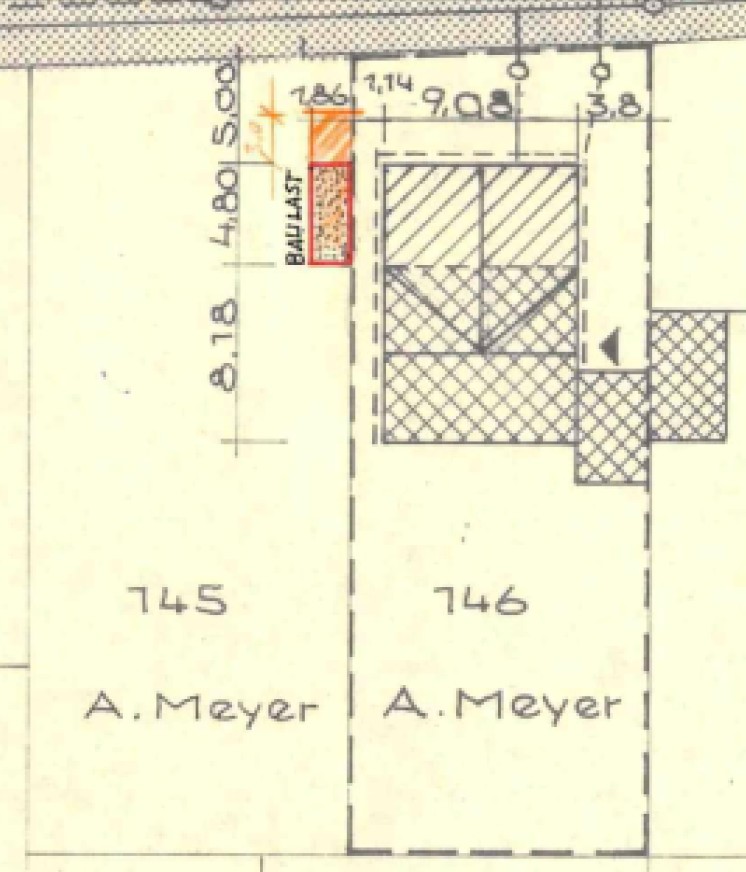

Regarding the site conditions:
We have a plot of approximately 14 x 35 meters (46 x 115 feet). Due to an easement, building right at the front of the property is not feasible, so the building needs to be set back about 10 meters (33 feet) from the street.
The width of our building is limited by the distance to the neighboring building.
The existing structure is only 1.14 meters (3.7 feet) from the property line. After consulting with the building authority, at least 5 meters (16 feet) distance from this building is required to build without fire protection measures.
This results in an effective building width of 7 meters (23 feet).

One question remains regarding setback distances for existing buildings / protected status.
After all, I received the information that I could build this way and only need to maintain a 5-meter (16 feet) distance due to fire protection from an employee at the building authority.
On what basis did they give this statement? What could they be referring to?
I also read in another forum that for existing buildings without entry in the land register, no setback to the neighboring property is required.
These are just statements, though. Therefore, I would prefer a reference to a specific legal paragraph or similar. Why "merged again"? From my point of view, plot 145 does not appear to be a newer parcel. On one property, buildings could even be constructed directly adjacent to each other without setbacks (although this could lead to a higher building classification), and fire protection would be assessed differently.

Building window, building line and boundary: 3.5 m (11.5 ft) from the street f_meyer schrieb:
However, we have to build set back (plot shown in the screenshot) and are about 10 meters (33 ft) from the street. Then why 10 meters (33 ft)?

Why "reunited" again? Before the division, parcels 145 + 146 were one large property. This division was made in the course of an extension.
I assume the five meters mentioned by the building official relate to an opening facing you in your mother’s garage wall or something similar, and then, as mentioned, would probably even apply to buildings with special boundary privileges on your property. Yes, of course it’s speculative. But today I spoke again with another employee, because this whole topic is bothering me and I wanted to get a better understanding from them.
The outcome was again that a 7-meter (23 feet) width and 5-meter (16 feet) distance to the neighboring property must be maintained.
Therefore, a viable option is indeed:
I would therefore submit a preliminary building inquiry and not rely on verbal statements. I had my father send me a document.
There is a building encumbrance (easement) in the front area due to the extension. This explains the corridor and the staggered construction.
If the distance to the encumbrance is observed, the building would be extremely narrow. Therefore, the building should start where the encumbrance ends -> this results in almost 10 meters (33 feet) to the street.
I calculate a house width of about 7.60 meters. Could you explain how you arrived at approximately 7.60 meters (25 feet)?
From my perspective, that would also assume that two times 3 meters (10 feet) of setback area on the own property are maintained, but setbacks from the existing building (without encumbrance) do not have to be taken into account.

the staggered construction method. Where exactly do you see a staggered construction here? There is a straight line on the west side!
f_meyer schrieb:
the corridor What exactly do you mean by corridor?
f_meyer schrieb:
If the setback to the easement is observed, the building would be very narrow The main thing is to comply with the easement. In that case, no additional setback is required.
f_meyer schrieb:
Therefore, the building starts where the easement ends -> this results in nearly 10 meters to the road No, that is not clear. But never mind, if you build further back, you can place a carport or a bike shed at the front.

f_meyer schrieb:
Building restriction in the front area due to the extension. That also explains the corridor and the staggered construction.
If the distance to the building restriction were observed, the building would be very narrow. Therefore, the building starts where the restriction ends -> this results in nearly 10 meters (33 feet) to the street I don’t know where you get the idea that a house should have the same width from front to back. Besides, I don’t see the setback area as limited to the registered building restriction area. Apparently, at the original construction date of the mother’s house, it was allowed not to maintain a boundary setback from a plot within the same ownership, and the main house was built at a distance of 9.80 meters (32 feet) from the street. When the extension was later added onto the yard, the situation must have changed to the current valid conditions, and the building permit was issued with the condition that the building restriction area be recorded to assume the setback area.
Your assumption that you may begin construction behind the setback area—approximately 10 meters (33 feet) from the street-side boundary and roughly aligned with the mother’s main house—with only a 3-meter (10 feet) boundary setback, I consider mistaken. In my view, your boundary setback extends beyond the marked area, covering the full depth of the mother’s house, which is a substantial 18 meters (59 feet) from the street boundary. Furthermore, a street-side setback of 5 meters (16 feet) seems most likely to be regarded as “correct” in this case.
