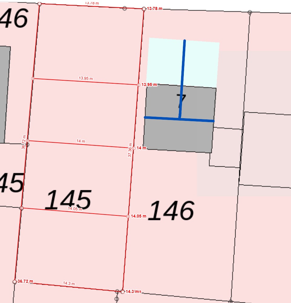

Thanks for the detailed explanation about the setback distances. Now I understand!
To clarify: the narrow plot on the right (with house number 7) and the 1.14 m (4 feet) setback belongs to my mother. The plot to be developed also belongs to my mother and will be transferred to me. It was once a large plot and was then divided during an extension (to the north of number 7). This explains the small setback of the existing building.
The 5-meter (16 feet) distance is based on § 30 of the building code of North Rhine-Westphalia (NRW), paragraph 1.
1. as the end wall of a building, except for buildings without habitable rooms and without fireplaces, with no more than 50 cubic meters (1765 cubic feet) gross volume, if these end walls are built on or at a distance of less than 2.5 m (8 feet) from the neighboring boundary, unless a distance of at least 5 m (16 feet) to existing or future buildings permitted by building regulations is legally ensured.
Therefore, the official stated that we are allowed to build with a minimum distance of 5 m (16 feet).
One more question on this:
Since this is a construction project within the family, would it be possible, with my mother’s consent, to reduce the 6-meter (20 feet) setback anyway?

Is the plot located in WA II? Yes, the plot is in WA II.
Then please show the entire plot with orientation and dimensions. Possibly also the full zoning plan, not just excerpts but in its entirety. Here is the plot with measurements. North orientation.
For your information: an extension was added later to building number 7. I have marked the ridge lines on both buildings. That might be relevant.
And here is the link to the zoning plan (plot 145):
o-sp.de/download/paderborn/467228
