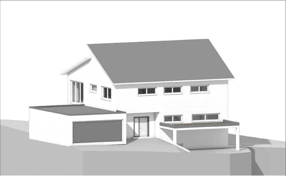

Frederick7612 Apr 2018 20:05
once again, here’s a quick update from the original poster.
In recent weeks, the focus has been on financing discussions and consultations with the energy advisor regarding KfW 40 Plus.
Work on the design and modifications will continue next week.
Regarding the off-topic posts about living arrangements, I won’t comment—everyone has their own ideas; I found some posts here a bit overinterpreted as floor plan criticism...
Based on YPG’s suggestion, attached is a rendered version of a staggered shed roof. We are currently considering how best to access the children’s bedrooms with the expanded roof space.
The rest of the changes will follow next week.
Good luck,
Fred
