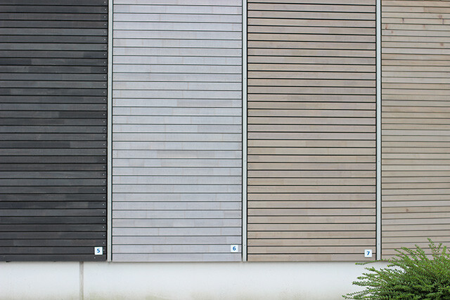

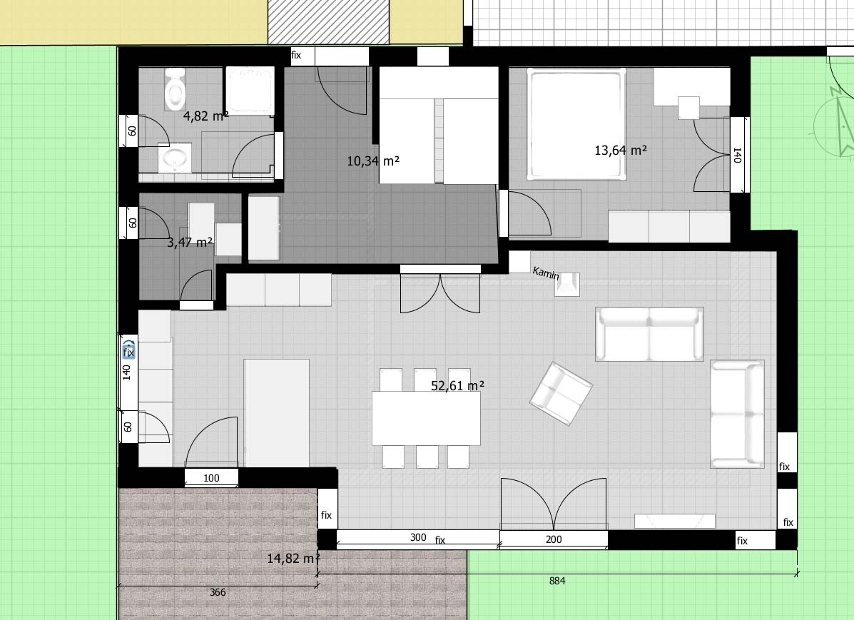

flusskiesel10 May 2017 22:21Yes, the gable windows are indeed quite common, but the rooms behind them (children’s room and bathroom) do need natural light.
The window frames will be dark gray. When selecting finishes, I will also consider wood-look windows, but even in 2017, I’m not convinced that they really look good.
Attached is the floor plan of the house.
What do you think of the wooden cladding in image 7 (lava gray)?
