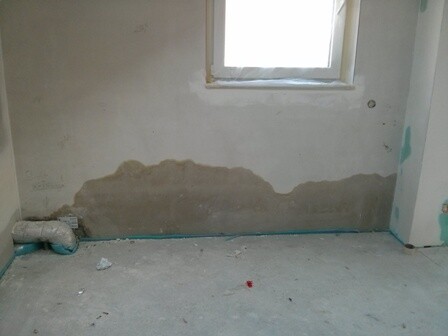

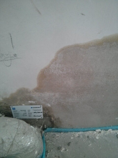

We have purchased a condominium that is currently under construction. Today, we visited the site again to check on things. We noticed large stains on a wall that faces our rooftop terrace. There was a significant amount of water standing on the terrace for an extended period... neither of us has any experience, and incomplete knowledge won’t get us far.
So my question to you is: is this normal or a cause for concern? Could this lead to mold on the walls in the worst case, or is there no reason to worry? What do you think?

DieVeräääna schrieb:The interior work already looks quite advanced. Is the exterior facade completely finished? And could you please post pictures of the wall from the roof terrace?
So my question to you is, is this normal or should I be concerned? Could this possibly lead to mold on the walls in the worst case, or is there no reason to worry? What do you think?
