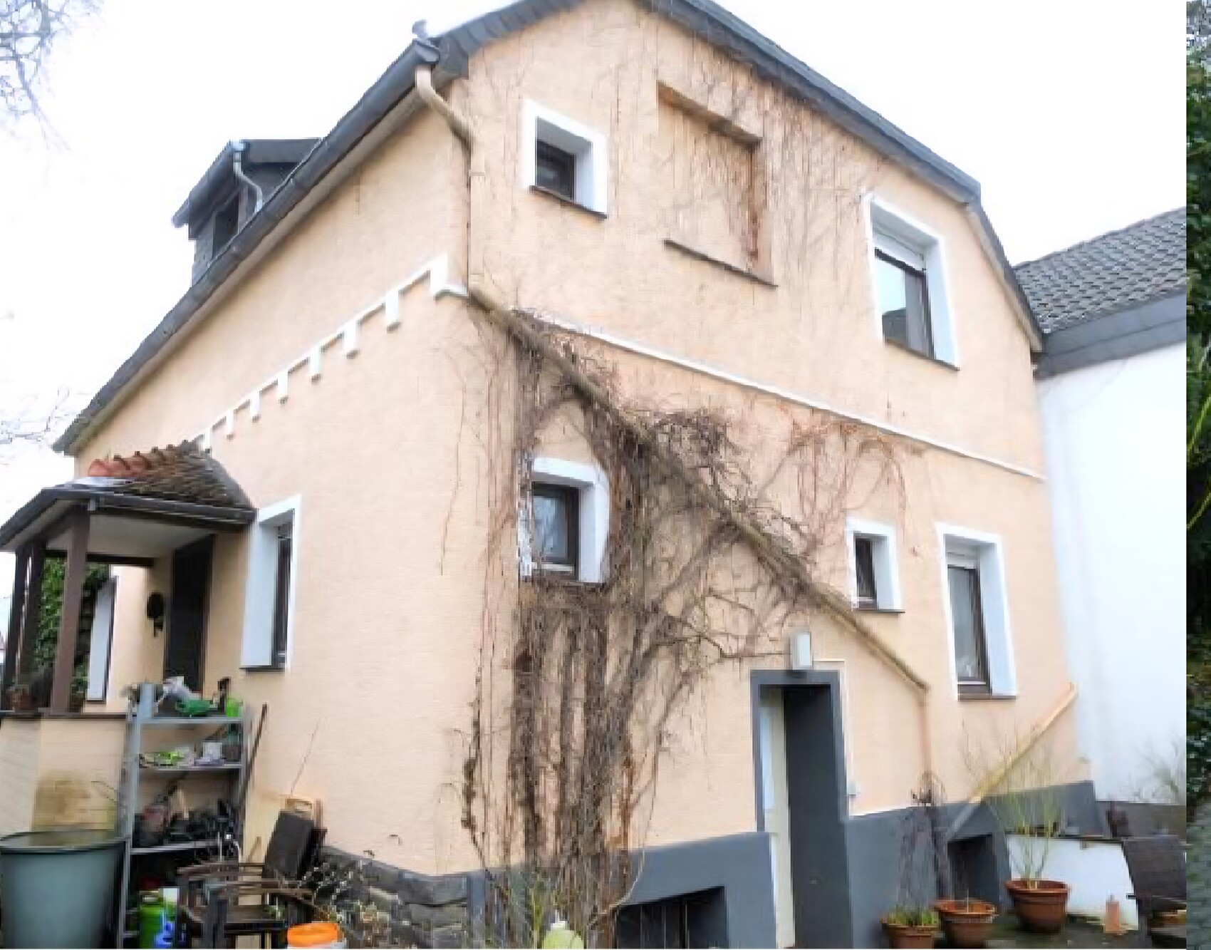

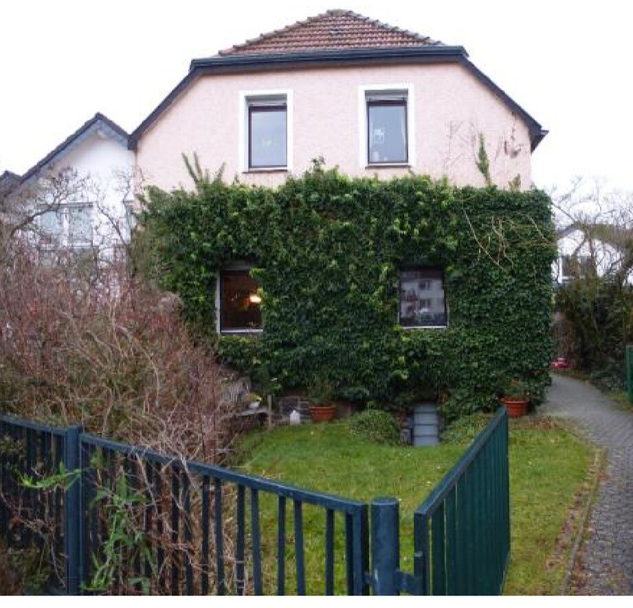

I am currently out with the kids and therefore have limited access to the plans, which are quite inaccurate anyway. We need to measure everything again (or have it measured). Unfortunately, the photos don’t show much except for vegetation that needs to be removed.
With the current new build prices being asked, we can hardly afford demolition and rebuilding without a lottery win. Especially since there are still subsidies available for renovation.
The architects who visited the site independently (two retired acquaintances and the one we might possibly work with) all agreed that we should renovate thoroughly instead of demolishing. They also all said that adding a story on top is cheaper than building an extension. Therefore, I assumed this is the better option for us.

Siedler346 Aug 2025 22:31This is a really beautiful house!
