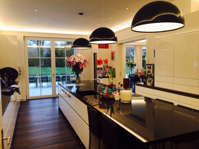

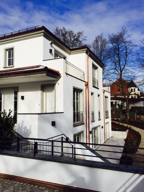

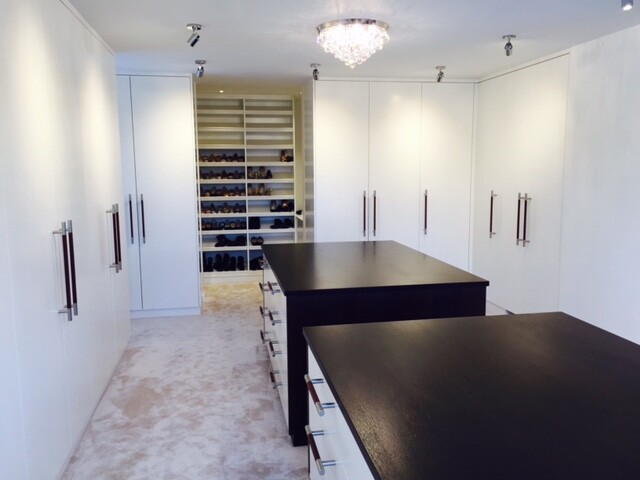

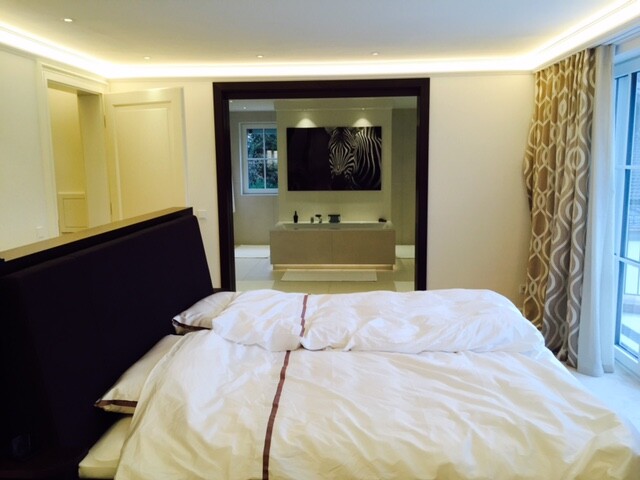

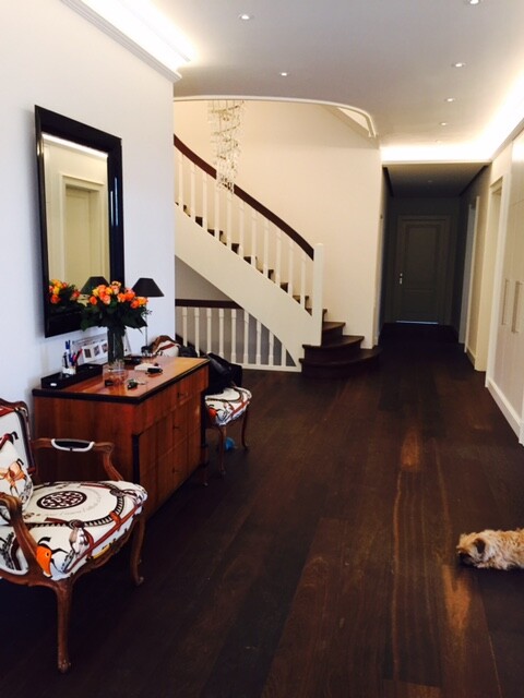

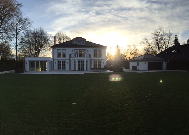

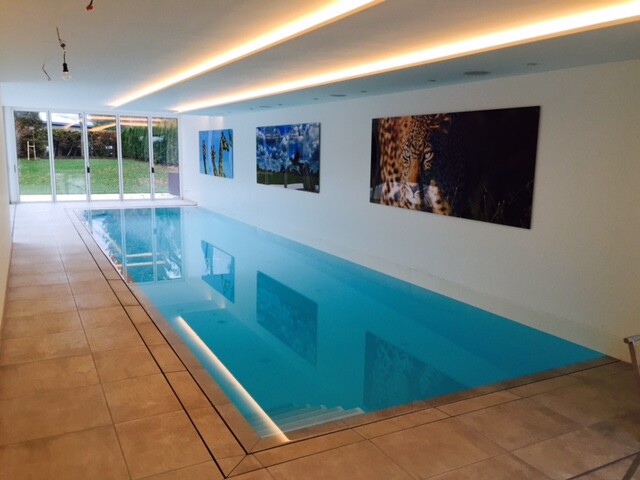

maniac66926 Apr 2016 21:43Hi,
If you look at the link below from me, you’ll find a similar property to what you want to build here.
We have 450 m² (4,844 sq ft) of living space, but including additional areas, it’s over 600 m² (6,458 sq ft).
The shell construction was cheap (350), but from there on it gets expensive.
The kitchen alone cost 100.
Just the paved driveway was around 50.
The garden with all the features cost 200.
Hi-Fi/video equipment can quickly add up to 100.
An alarm system is a must for a property like this and costs around 30–40 (video system, outdoor and indoor motion detectors, window security, etc.).
The indoor pool cost about 300.
I’m happy to share pictures when I have time and feel like it.
All in all, our property cost just over 3. Some things can be saved on, but under 2 you won’t get what you expect.
With a house like this, everything costs a bit more. Windows won’t be standard size, doors neither, and so on.
Hope this helps for now...
https://www.hausbau-forum.de/threads/efh-mit-schwimmbad.12860/
