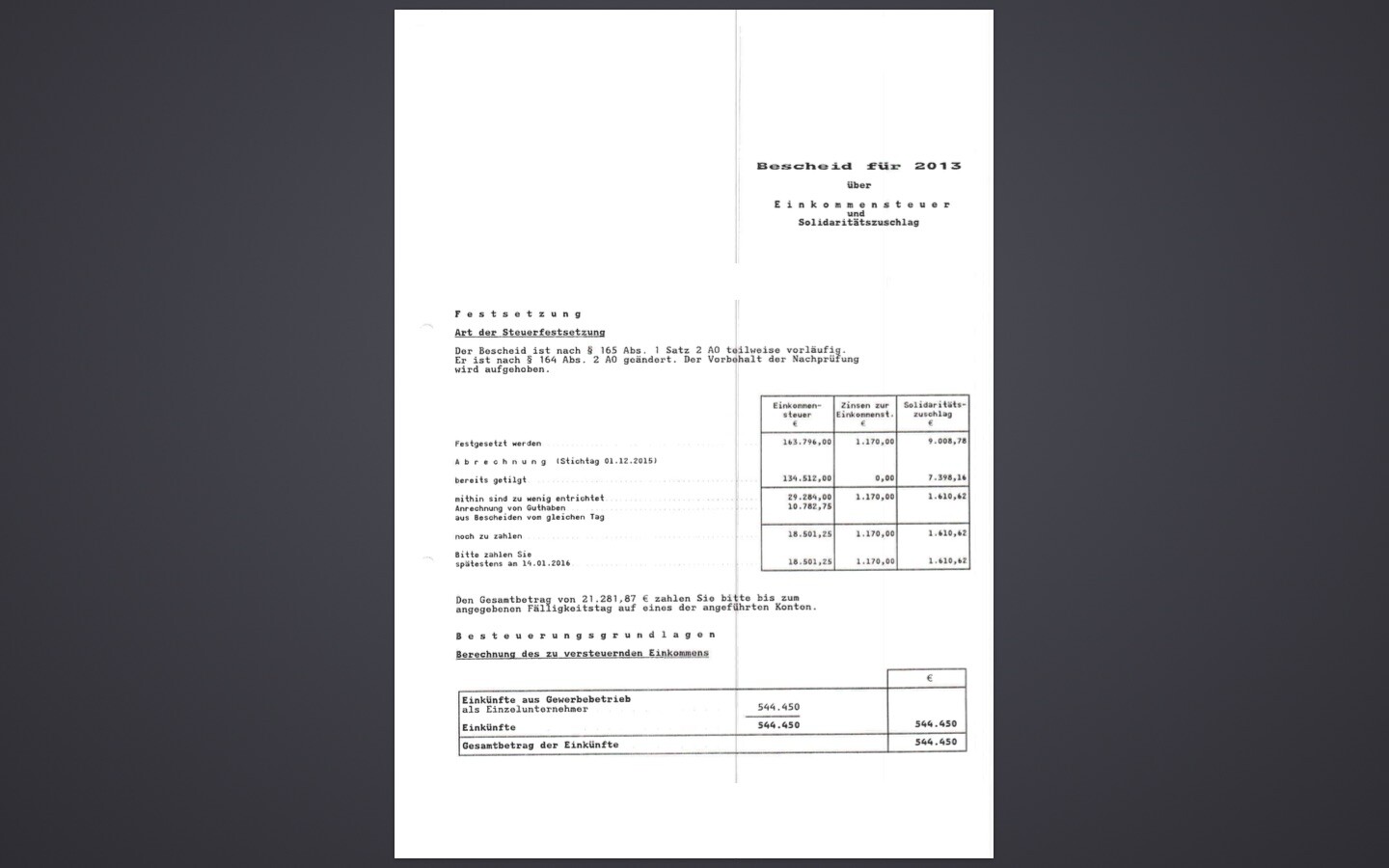

Peanuts7419 Apr 2016 14:24Steffen80 schrieb:
I’m completely relaxed about this... if needed, I’ll even post my tax assessment notice That doesn’t say much. I think someone once fooled a lot of investors with this. He showed a tax assessment notice listing tens of millions in income, which he could easily report as self-employed. Then, when he was supposed to pay tens of millions in taxes according to that notice, he simply submitted a revocation, claiming he had made a mistake in three digits *lol*
