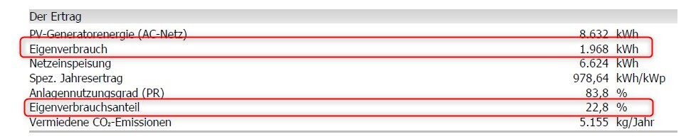

- Electricity generation or specific yield (ask about the data source, e.g., photovoltaic simulation with software or PVGIS database. Be skeptical if one provider's figures differ widely from others in their offer)
- Share of self-consumption (about 20% without battery, about 40% with battery for 10 kWp; about 30% for 5 kWp without battery) (Source: Volker Quaschning/HTW Berlin)

- Assumption: 22% self-consumption (source: "Optimal sizing of photovoltaic storage systems" by Volker Quaschning HTW Berlin, adjusted for east-west orientation)
