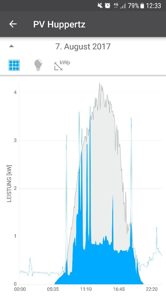

toxicmolotof16 Mar 2018 12:38I can reach the 70% mark relatively quickly, but it is difficult to exceed it significantly or maintain it consistently.
Here is an example of a day where reaching around 70% self-consumption was beneficial, though I didn’t consciously choose for or against it. It was more because there was practically no extra effort involved and the system allowed for it anyway.
Photo: The peak would have been clipped here, but let’s assume it’s about 1 kWh, and optimistically apply that to 30 days per year... (5.4 kWp system).
toxicmolotof16 Mar 2018 12:45Cap from 12 to 4 pm during the peak of 500W over the cap... so not 2kWh... and from that, I roughly calculated about 35 days in 2017.
So maybe 40-50kWh is realistic.
There will probably be more losses in systems that are a) larger and b) optimally oriented. But for that, you would need someone who faces fully south and has a 20° tilt. In that case, such a peak naturally has a full impact on the days when it is possible.
Your estimated 50 kWh would result in a lost feed-in compensation of €120 over 20 years. The Sunny Home Manager was offered to us for €590. So, €590 would not be worthwhile for you either.
But yes, if you have only one half of the roof covered, reaching 70% is quite common, especially if the system is perfectly south-facing. With an east/west system, you almost never reach 70%, or at least very rarely.
