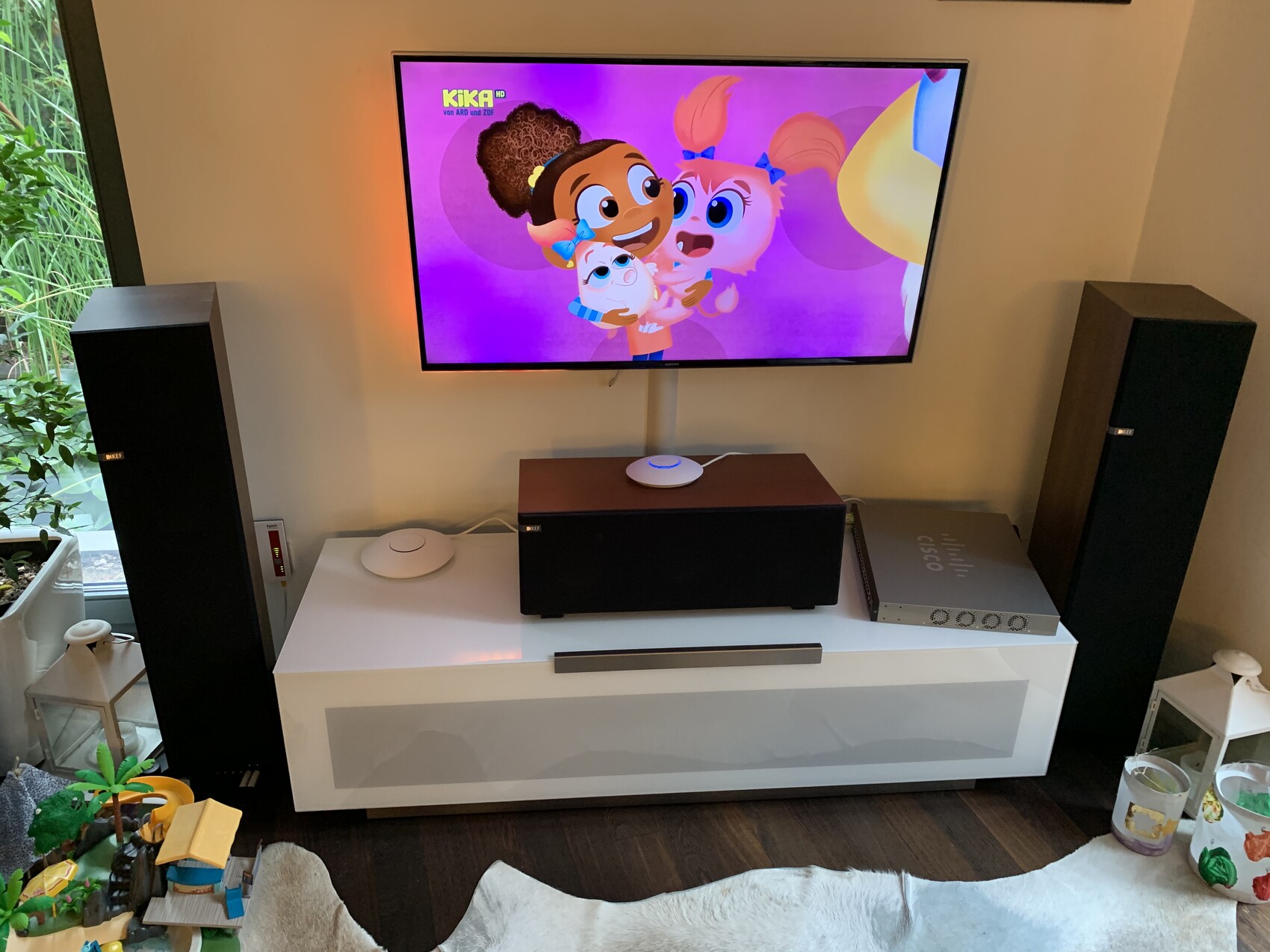

Tarnari25 Aug 2020 18:23
Next update:
Nano HD connected, IGMP snooping enabled, all mobile devices routed through the Nano, as well as the server, workstation, and Magenta receiver connected to the Cisco switch. So far, everything is working.
This is what the test setup looks like right now xD
Fernseher mit buntem Kinder-Animation-Bild, zwei Standlautsprecher flankieren weiße Kompaktanlage.
knalltüte
25 Aug 2020 18:25
Nice ... and the AVM little gem is still active just in case the Nano HD ever fails?
Tarnari25 Aug 2020 18:27
No xD
To be honest, only for now, because I’m just testing the setup. Once I know everything is working, it will be put away until we move into the house.
Even if the volume is okay, it’s not really necessary in the apartment.
