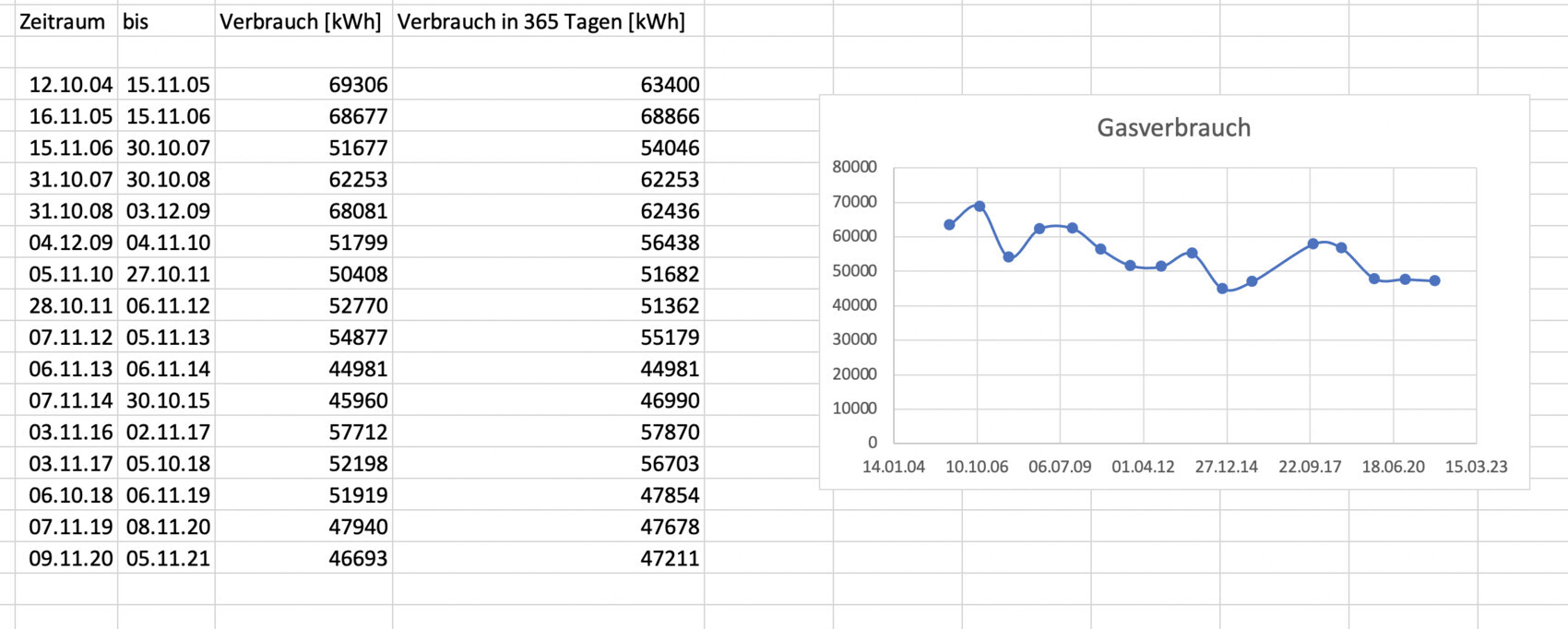

Lukas453629 Aug 2022 00:29One more basic question: can I compensate for a (slight) oversizing by using a somewhat larger buffer?
L
Lukas453629 Aug 2022 00:50Another idea that could explain the high consumption: at least 300-400 liters (80-105 gallons) of hot water at 60°C (140°F) are used daily. How much does this contribute to the heating output?
SaniererNRW1239 Aug 2022 07:30Lukas45362 schrieb:
One more simple question: can I compensate for a (slight) oversizing with a somewhat larger buffer?The professional would slightly undersize and omit the buffer.Lukas45362 schrieb:
Another idea that could explain the high consumption: at least 300–400 liters of hot water at 60°C (140°F) are used per day. How much of the heating output does this represent? If you heat 400 liters from 10°C (50°F) to 60°C (140°F), that is about 20 kWh. Or 7,000 kWh per year. Based on the 32,000 kWh you mentioned, that’s roughly one fifth. By the way, that is equivalent to 3 large bathtubs every day. Do you have a hair salon or something similar?
