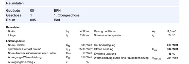

Works. I just quickly checked the underfloor heating design.
Table view: room data and performance data of a building room (dimensions, area, heating).
If the underfloor heating can only deliver about half of the required output in the bathroom, it won’t be able to reach 24 degrees Celsius (75°F). An additional heat source is needed for that (electric wall heater or similar) — is one available?
The pipe spacing in the bathroom is only 10 cm (4 inches). With 5 cm (2 inches), the underfloor heating would provide enough output.

If the underfloor heating can only provide about half of the required output in the bathroom, it can't reach 24 degrees Celsius (75°F). An additional heat source is then necessary (electric wall heater or similar) ==> available?
The tile spacing in the bathroom is also "only" 10cm (4 inches). With 5cm (2 inches), the underfloor heating would deliver enough power.
Well, great, then we probably weren’t properly advised, or it was simply overlooked. No, at least for now, there is no additional heating installed.

Great, so it seems we were not properly advised, or it simply wasn’t taken into account. No, there is “at least for now” no additional heating system installed.
A clear yes. You need to discuss this with your heating contractor / general contractor or whoever handled the planning. At any rate, whoever was responsible for the design.
Sorry to be the one to bring this bad news first.
