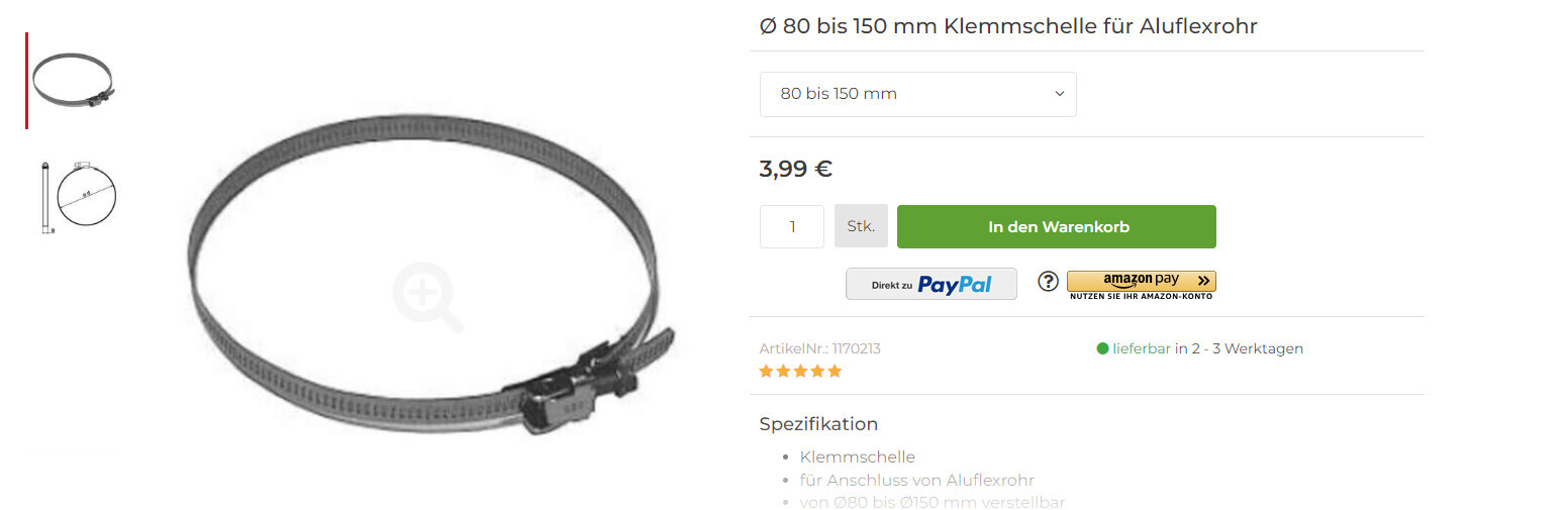

KarstenausNRW28 Jun 2023 15:36X
xMisterDx28 Jun 2023 21:37With all due respect... if you only know about sealing tape and are unfamiliar with pipe clamps... you might want to leave that to others.
I also expressed myself unclearly, I wrote this in a hurry, please excuse me. Here is a more detailed explanation:
There is a 150mm (6 inch) PVC pipe installed in the concrete slab. On top of that is a 16cm (6.3 inch) floor structure, finished off with a floor tile.
If I expose the PVC pipe now, I have 16cm (6.3 inches) of air below it. I can’t attach a pipe clamp around it without cutting open the floor to about 250cm (98 inches), which I want to avoid.
Simply inserting the aluminum flexible duct into the floor and sealing it at the tile edge probably wouldn’t be the best solution, right?
I’m basically looking for a way to connect my fresh air supply in the concrete slab with as little effort and minimal cutting of the floor tile as possible.
