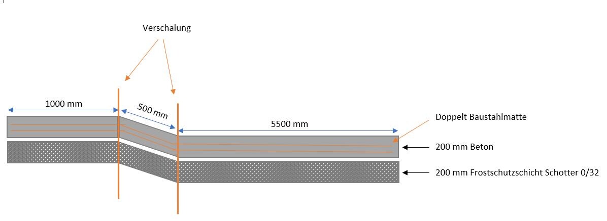

We are currently planning our outdoor area and would like to build a pool ourselves. The pool will be constructed from 17.5 cm (7 inch) concrete formwork blocks and will be fully embedded in the ground on two sides, while about two-thirds of it will extend above ground on the other two sides.
We have put together a cost estimate and are now looking to cut expenses where possible.
One major cost item is the concrete slab. Originally, a concrete truck with a pump was budgeted, but this is one of the largest expenses in the plan, so we would like to pour the slab ourselves.
We definitely have the necessary skills and sufficient physical strength.
The pool will measure 7 x 4 meters (23 x 13 feet), and with a 20 cm (8 inch) thick slab, about 5.6 cubic meters (about 7.3 cubic yards) of concrete will need to be poured.
That is quite a lot of concrete to mix and work by hand with a concrete mixer.
Therefore, our question is whether the slab can be poured in sections.
The setup would be 20 mm (0.8 inch) gravel, then a mesh of double-layer steel reinforcement mats. The pool will have two levels connected by a slope.
As shown in the attached sketch, can the slab be divided into these three sections and poured separately, or would that be ineffective and not durable in the long term?
The connecting reinforcement would be in place for the individual sections.
I’m looking forward to your knowledge and feedback.
Thank you very much.

Foundations can be built in sections if done properly.

Thanks for the advice.
Everything is fully planned and budgeted at 15,000 euros. It’s still unclear whether we will go for a liner pool or tiled finish, but we already have quotes from a professional for installing the liner. A counter-current system is unnecessary—it’s only meant for cooling. All the technical aspects have already been planned.
The materials will, of course, be delivered by the building materials supplier. The excavator is ready to start digging the hole.
My main question now concerns the foundation slab.
When you say it can be done in sections if done properly, it makes me wonder what “done properly” actually looks like.
Could you share some details on this, or are there any websites where I can see examples? I haven’t found anything so far.

You should be able to handle 5.6 m³ (200 cubic feet) by hand in one day with help.
Just strip the formwork and install the reinforcement connections.
