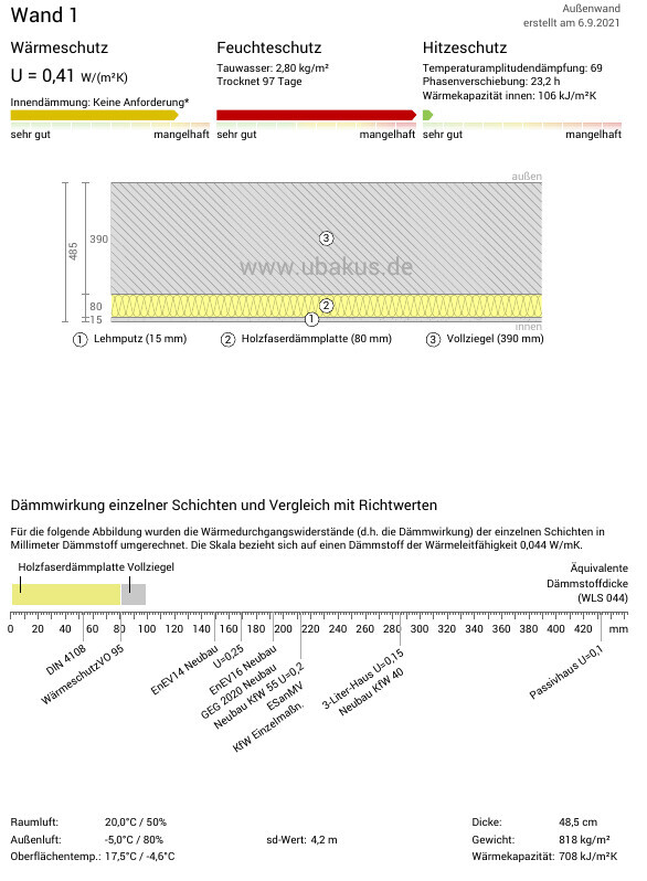

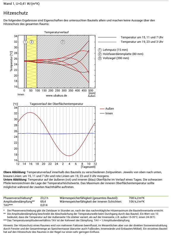

danabanana7 Sep 2021 08:38Very interesting! I have uploaded the results as screenshots:
As far as I understand, I can work with wood fiber boards at a thickness of 80mm (3.1 inches).
I tested with 100mm (3.9 inches) insulation, but this results in a drying time of over 100 days during summer.
At the house location, winter temperatures rarely drop below -5°C (23°F), while in summer temperatures can exceed 30 to sometimes 40°C (86 to 104°F) for many weeks.
I hope I am interpreting the results correctly.
What do you think about the outcome? Can the insulation work this way?
