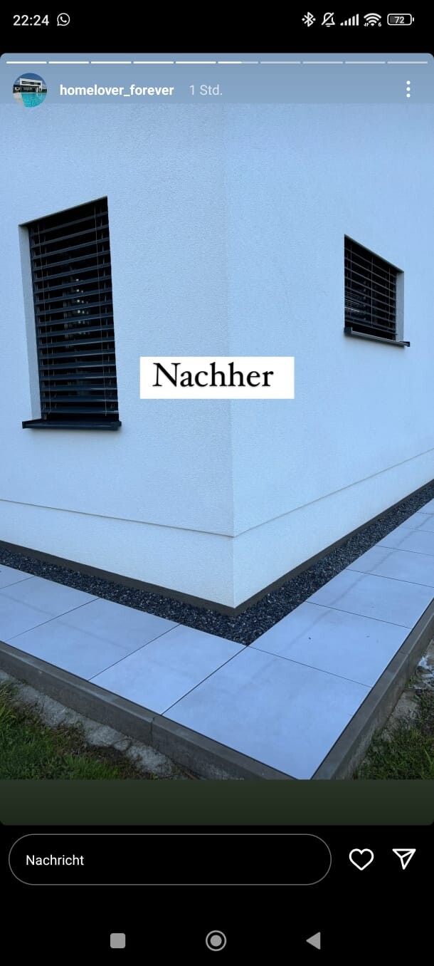

we have recently built a new house and are currently working on landscaping our garden.
We were advised to install a drip edge protection for the facade to better protect it.
On the internet, we found the idea of combining a drip edge with a pathway (see photo).
However, I am wondering how water can drain with such a solution. The frost protection layer should theoretically be made of gravel, right? Or am I mistaken?
What is the best way to handle this?
Thanks for your help
nordanney31 Aug 2024 10:46FaGo1986 schrieb:
But what I'm wondering is, how does the water drain with this kind of solution?What exactly is your problem? It’s basically the same as with a standard splash guard. The panels are sloped outward.B
Benutzer 100131 Aug 2024 19:27Install drainage, then cover it with inexpensive gravel, and on top of that, place the high-quality granite gravel.
