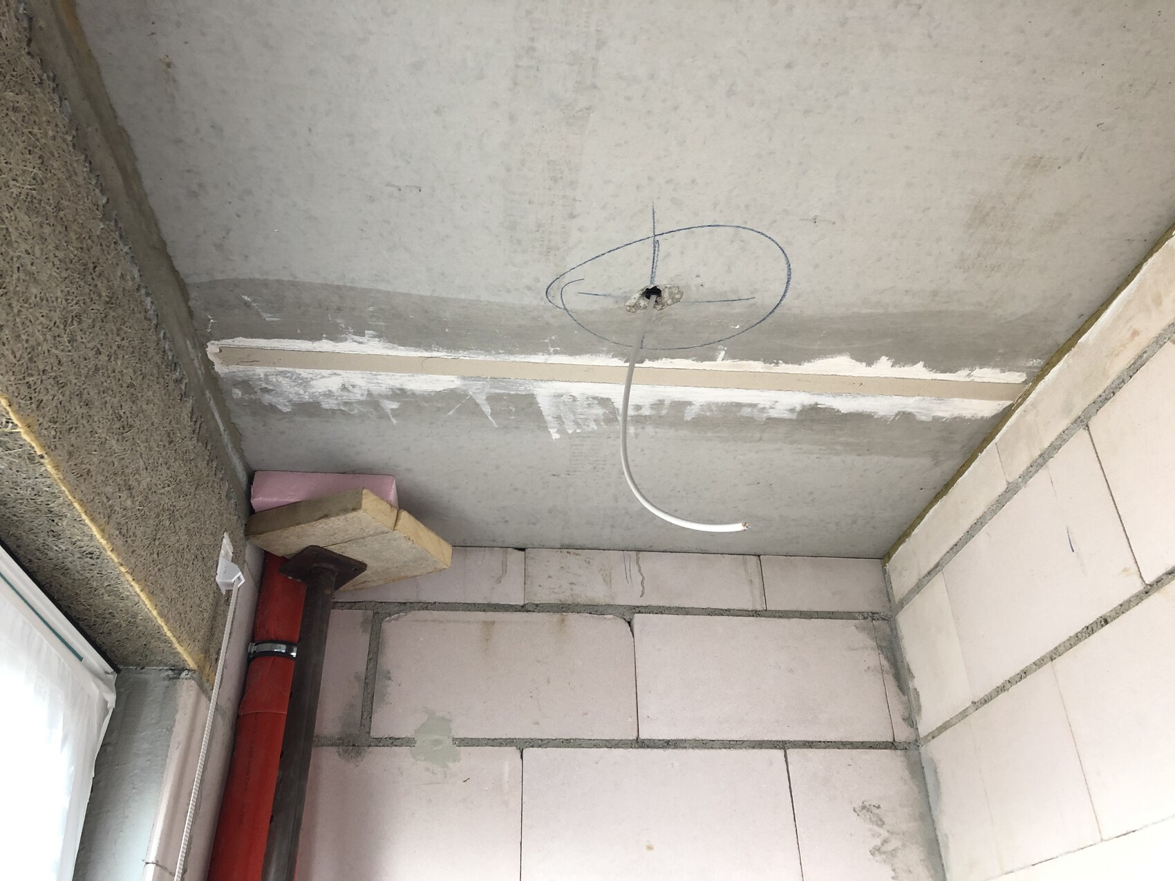

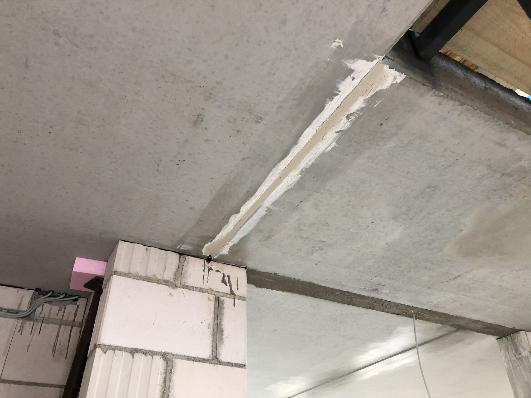

We have a precast concrete ceiling (Filigran slab) and since we decided to do the painting work ourselves, we also need to prepare the ceiling...
There are many different approaches out there.
Priming – filling (joints and surfaces) – applying painting fleece – painting is probably the most thorough and best method.
A friend told us that it’s often enough to just fill the joints and then simply paint... Is this a viable option? Has anyone tried this themselves?

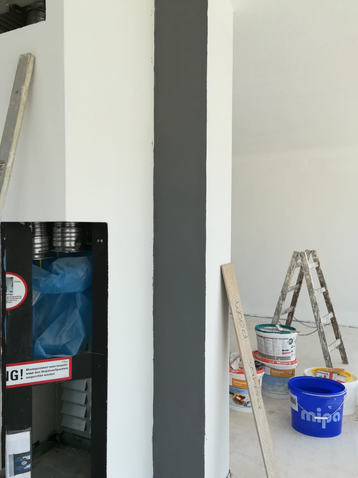

Cleaning the ceiling is a huge mess and usually costs a bit more per m² (square meter). I have no idea, the master painter took care of everything. I only had to complete my basic tasks on time. Everything was from MIPA, including the primer.

A friend told us that it is actually enough to just fill the joints with filler and then simply paint over them... Is this really an option? Has anyone tried this themselves?Yes, with us.
However, our bricklayer also filled the joints. He did a very good job.
We primed and painted. Not using standard ceiling paint, but painter’s paint from a wholesale supplier for professional painters.
Painted twice, it looked very blotchy under spotlight. In real life, you can’t see anything – we did a good job.
Grantlhaua29 May 2019 11:01ypg schrieb:
We primed and painted. Not Alpina, but paint from a wholesale supplier for professional painters, so a specialist dealer.
Painted twice, looked quite blotchy under spotlight. In real life, you don’t notice it – so we did a good job. It is important that if it is silicate paint, you apply it wet-on-wet. That means not painting the corners first, but covering all areas as quickly and broadly as possible. Additionally, using a thinner can help extend the working time.
