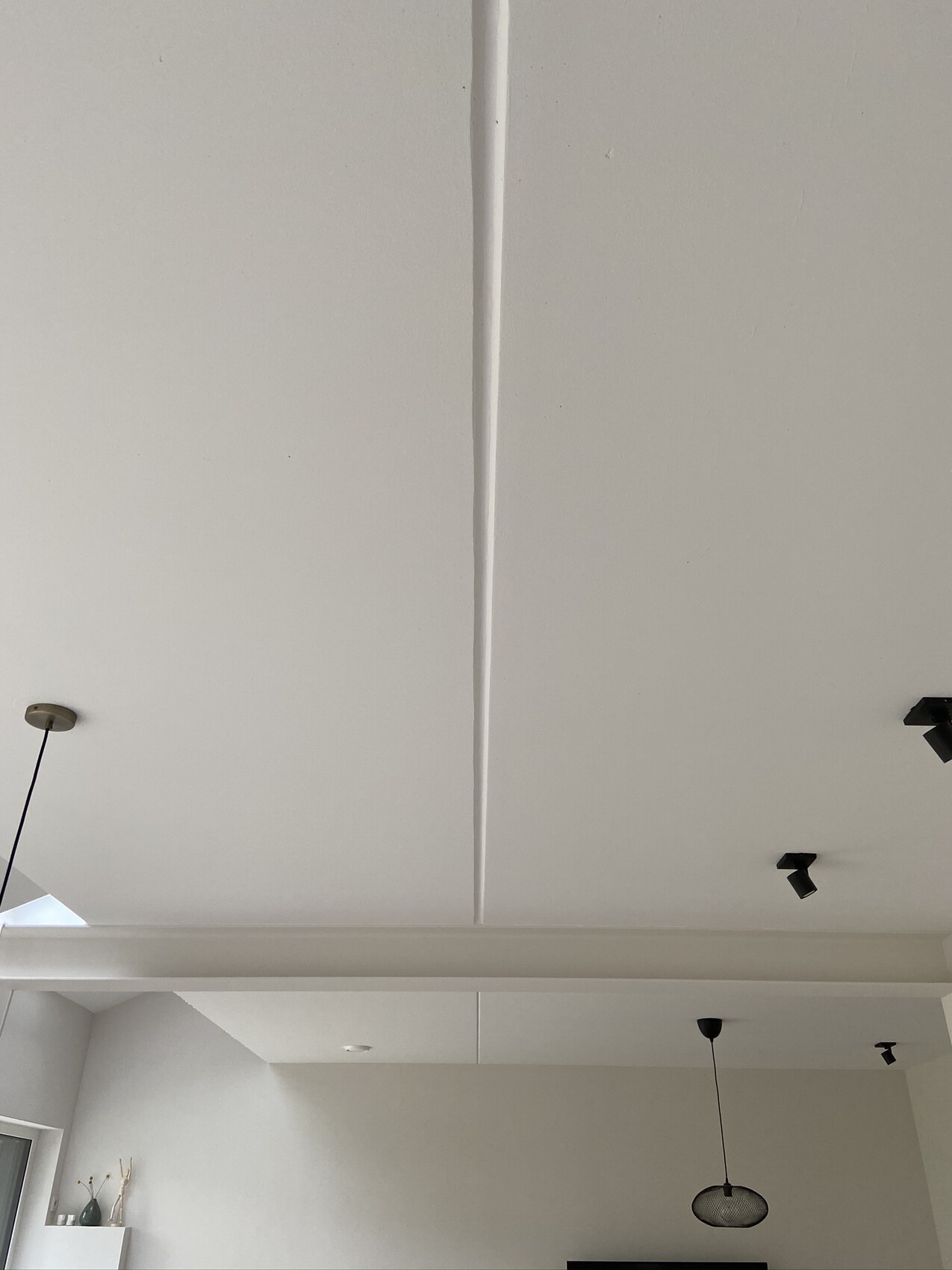

We filled the joints with construction adhesive, leaving them still visible. Then the ceiling was sanded, primed with an economical paint, and painted twice.
White ceiling with central joint, hanging pendant light, and ceiling spots in the open living area.

M4rvin25 Jun 2020 07:20
I’m generally very satisfied. Only at one joint can you see a slight transition. But I felt like I would have had to apply filler over about half a meter (1.5 feet) in both directions.
The painting itself could have gone a bit better, too. We only painted twice, and in the evening twilight, you can already see some streaks. It’s really quite hard to judge when the result is perfect.

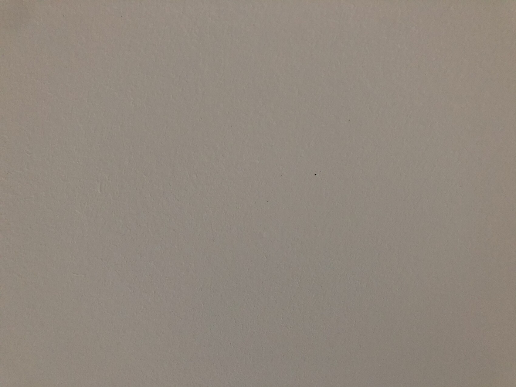

M4rvin25 Jun 2020 07:27
Here are some pictures.
At first glance, it looks like a normally painted wall.
If you look closely, you can see some small holes here and there.
(This could be avoided by filling every little hole, but I didn’t care.)
Ceiling fan in motion; turquoise curtains on the left, suitcase on the cabinet on the right.
Beige wall with slight texture; small black dot in the center of the image
