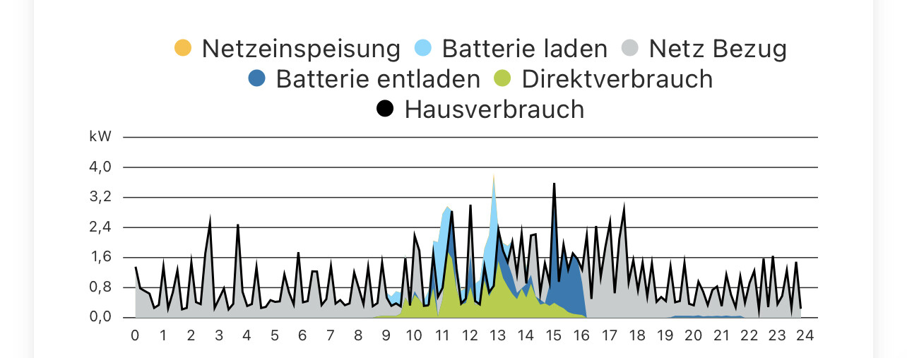

The geothermal heat pump display shows:
Hours: 19,672
Starts: 57,579
Starts per hour: 35.596
The suspicion of oversizing comes from the professional installer. Let’s see how it develops.I don’t want to offend you because you’ve already had a tough time getting the new compressor, and I wouldn’t wish that on anyone. But your heating system is not maintenance-free, and as a homeowner, you were given the user manual for a reason.
Who maintained the heating system? Was it done regularly?
For example, after the first year when I saw the heat pump turning on as shown in the screenshot, the service technician came the very next day. Back then, the counter showed just under 9,500 starts (or one start every 12 minutes). Now, three years later, it’s about 11,500 starts in total.
You can see that this is not unusual and happens quite often, especially if something is defective (e.g., room temperature sensor malfunction, expansion tank failure, underfloor heating loops not refilled, etc.).
