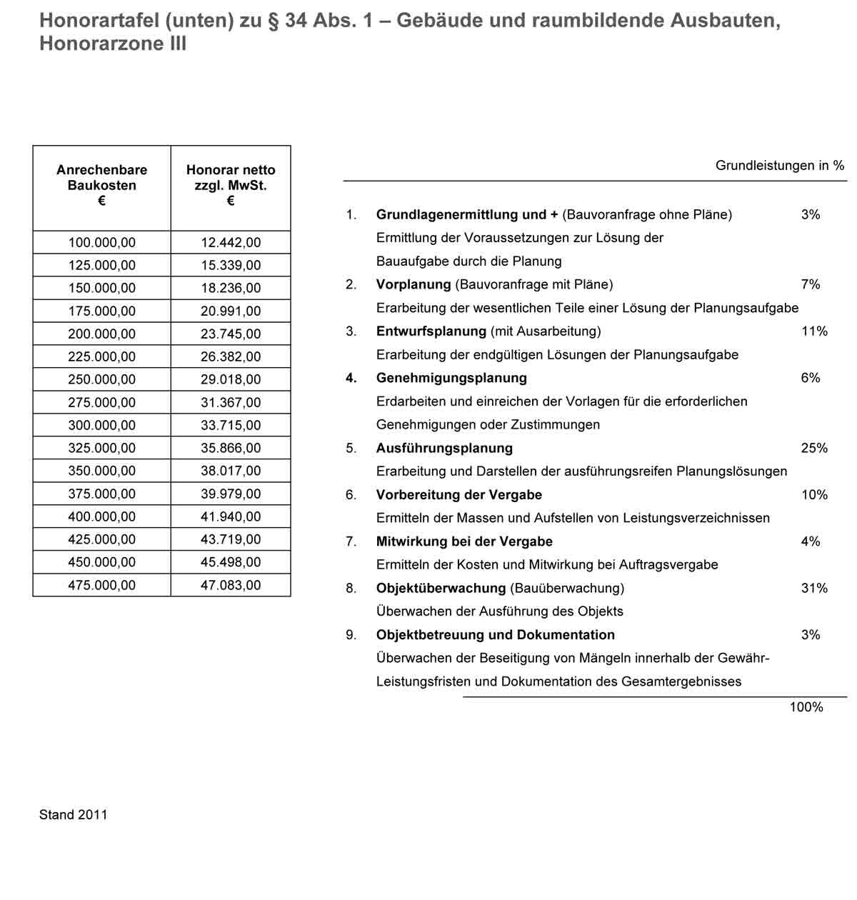

Could you possibly give me an estimate of what portion of the architect’s fee according to HOAI is appropriate for the service phases 6 to 9, if the architect only oversees the construction up to the completed shell with high-quality finishes? Around 50%? (Typical single-family house without special extras).
A rough guideline would be very helpful.
Regards
Markus13
Bauexperte
10 Oct 2012 14:45
Markus13 schrieb:
Could you possibly give me an estimate of what proportion of the architect's fee according to HOAI is appropriate for service phases 6 to 9, if the architect only oversees the construction up to the building envelope stage? About 50%? (Standard single-family house without special features).
You can easily determine the expected costs from the fee table.
Fee table with construction costs and service phases for building completion
