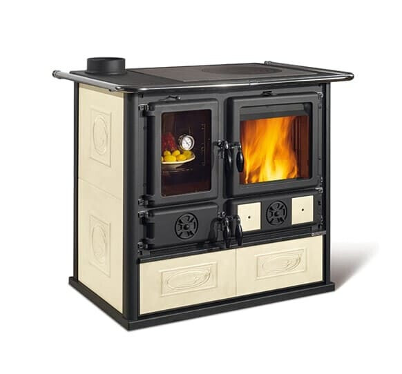

Buchsbaum06618 Nov 2024 13:10Aloha_Lars schrieb:
PS: I don’t have a chimney!That’s unfortunate.
I have something like this in my kitchen. Never going without one again! But if you don’t have a chimney, it gets complicated. Especially during the Christmas season, a kitchen stove is both a real saver because it includes an oven and incredibly cozy. But I guess you all have a nice heat pump for that.
