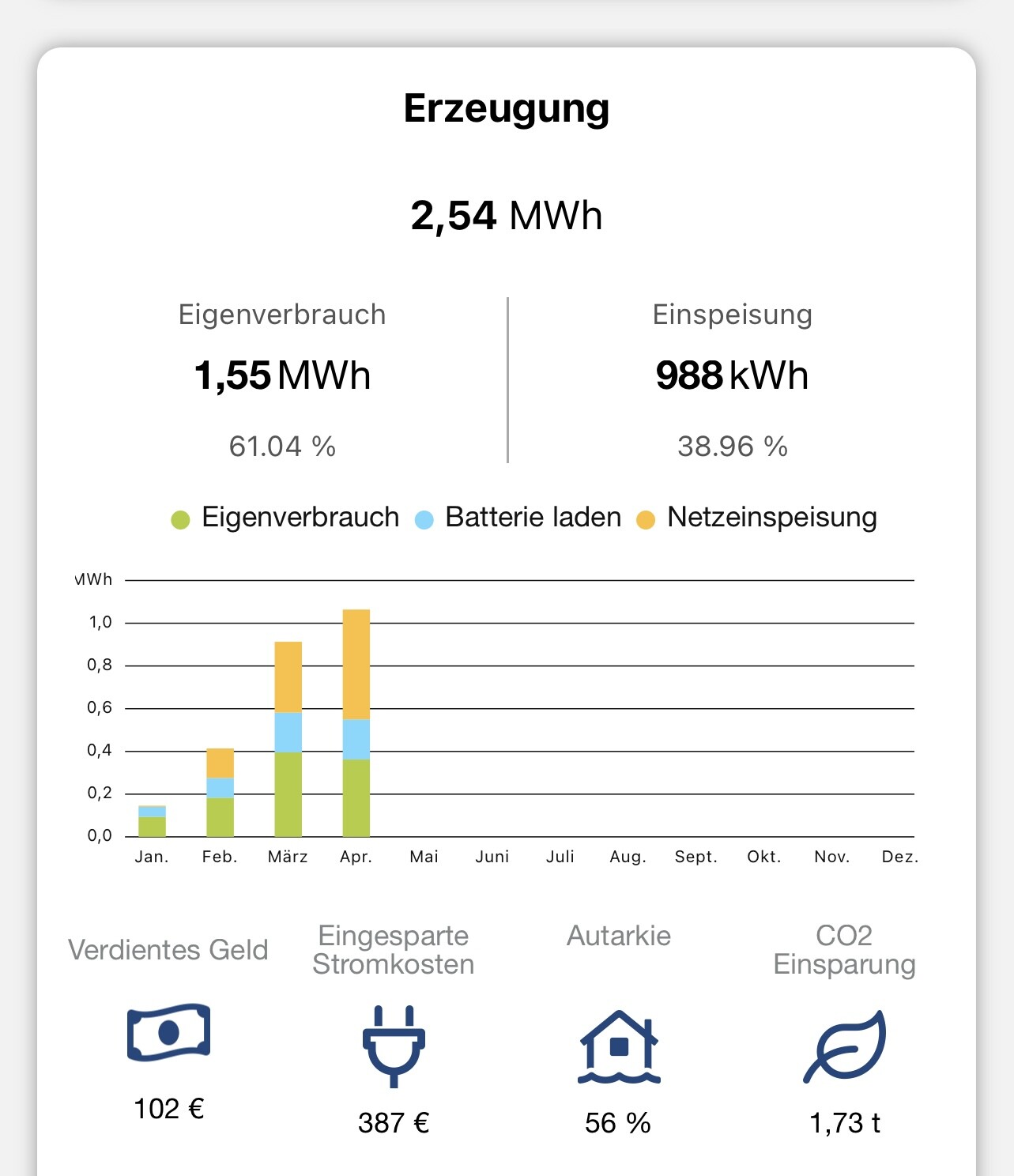

For self-consumption systems with surplus feed-in (which most rooftop systems likely have), it actually only makes sense to limit to about 7 kW module capacity at south-facing orientation to around 70%. What else? Anything else would be almost pointless even with a battery. Since mid-February, I’ve been feeding electricity into the grid nearly every day despite having a battery and an electric car.
Now imagine your system being capped for no reason between 11 a.m. and 1 p.m., losing about 3 kWh per hour, every day, over four months (rough estimate since not every day has full sunlight).
You don’t want that just to save 300–400€ once.

4lpha0ne schrieb:
As a hobby, I enjoy it (and it’s hardly more expensive than many other hobbies), but it also has the psychological effect that I make sure to turn off devices in the evening or start the dishwasher and washing machine only while the sun is still shining. So, my behavior helps me save some energy or extends the lifespan of the appliances. I completely agree and even take it a step further. Without a smart meter/inverter/solar panels, most people don’t really know how much electricity their devices consume.
You might notice that after going down to the basement/laundry room every two weeks, the meter shows 200–300 kWh (kilowatt-hours) more, but you don’t often think that the hairdryer uses 1.7 kWh, or that the dishwasher running at 60°C (140°F) for two hours consumes 2.4 kWh—even though it’s rated A+++++.
And when you see the dishwasher using more power than the heat pump, you really reconsider running it in the evening without sunlight.
