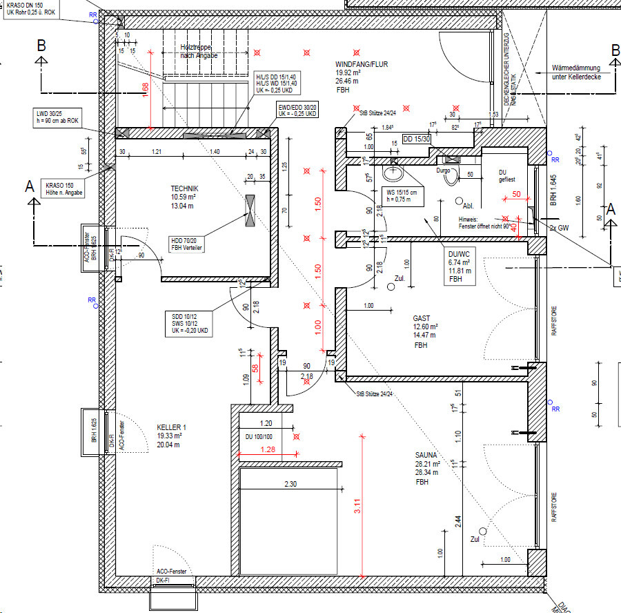

LuckyDuke20 Feb 2019 20:25First of all, thanks for the engaging discussion.
I also don’t think the basement will cool down below 16°C (61°F), since it is a KFW55 energy-efficient house and, as mentioned, the basement level is only partially unheated. Moreover, no laundry is washed or hung there.
Most of the space is used for living. For clarity, here is the factory plan. The white circles indicate supply or exhaust air, labeled respectively with the abbreviations “Abl.” and “Zul.”.
The plan was not made by me but by the installer. I am questioning it.
All rooms, including the hallway, are heated except for Basement 1 and the technical room. The basement side is built into a slope, therefore a white tank foundation with 120 mm (5 inches) insulation WLG 038. The front is masonry with U8 42.5 cm (16.7 inches) blocks, as with the rest of the house.
So, actually, there should be an exhaust air vent in the technical room and a supply air connection in Basement 1, right?
Or maybe nothing at all, since opinions seem quite divided.
But we will hardly ventilate actively; who thinks about that in a basement? And leaving a window open overnight would cool everything down, which nobody wants.
Christian
