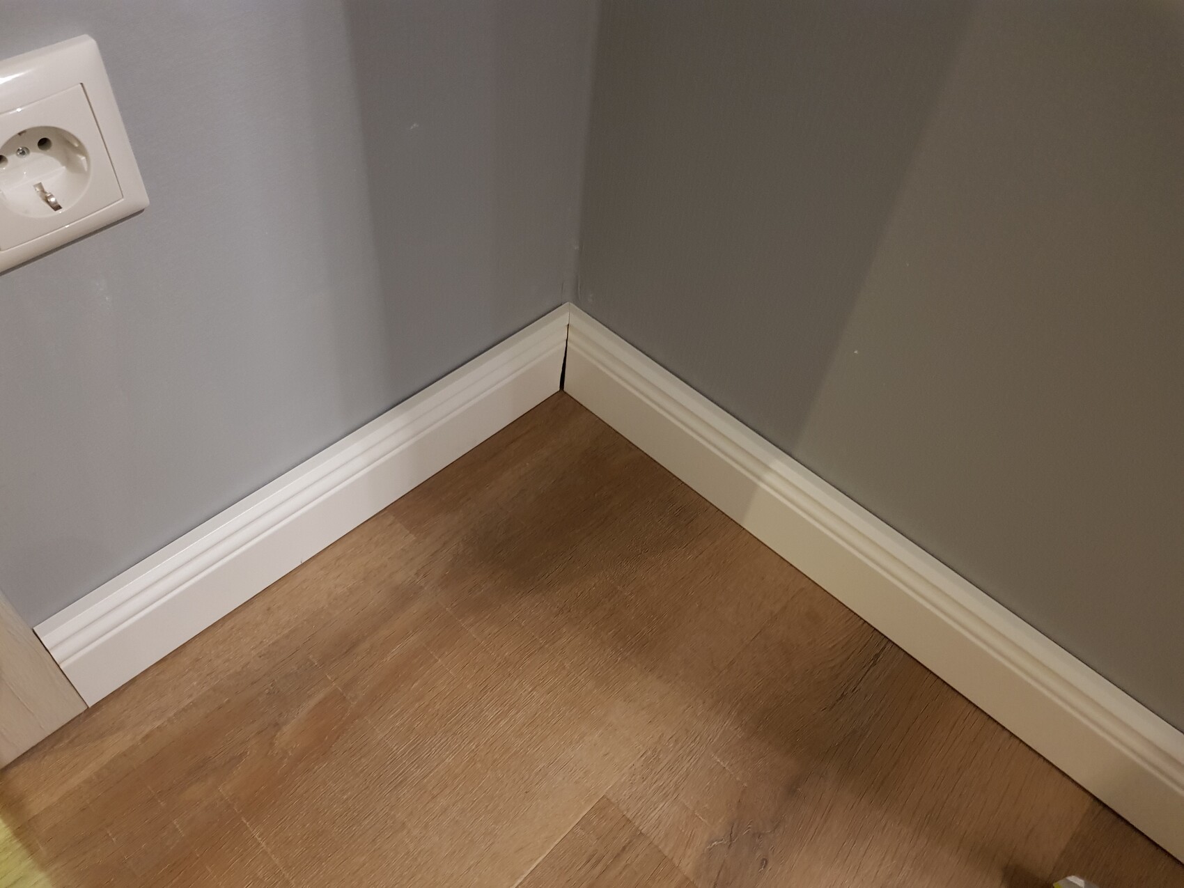

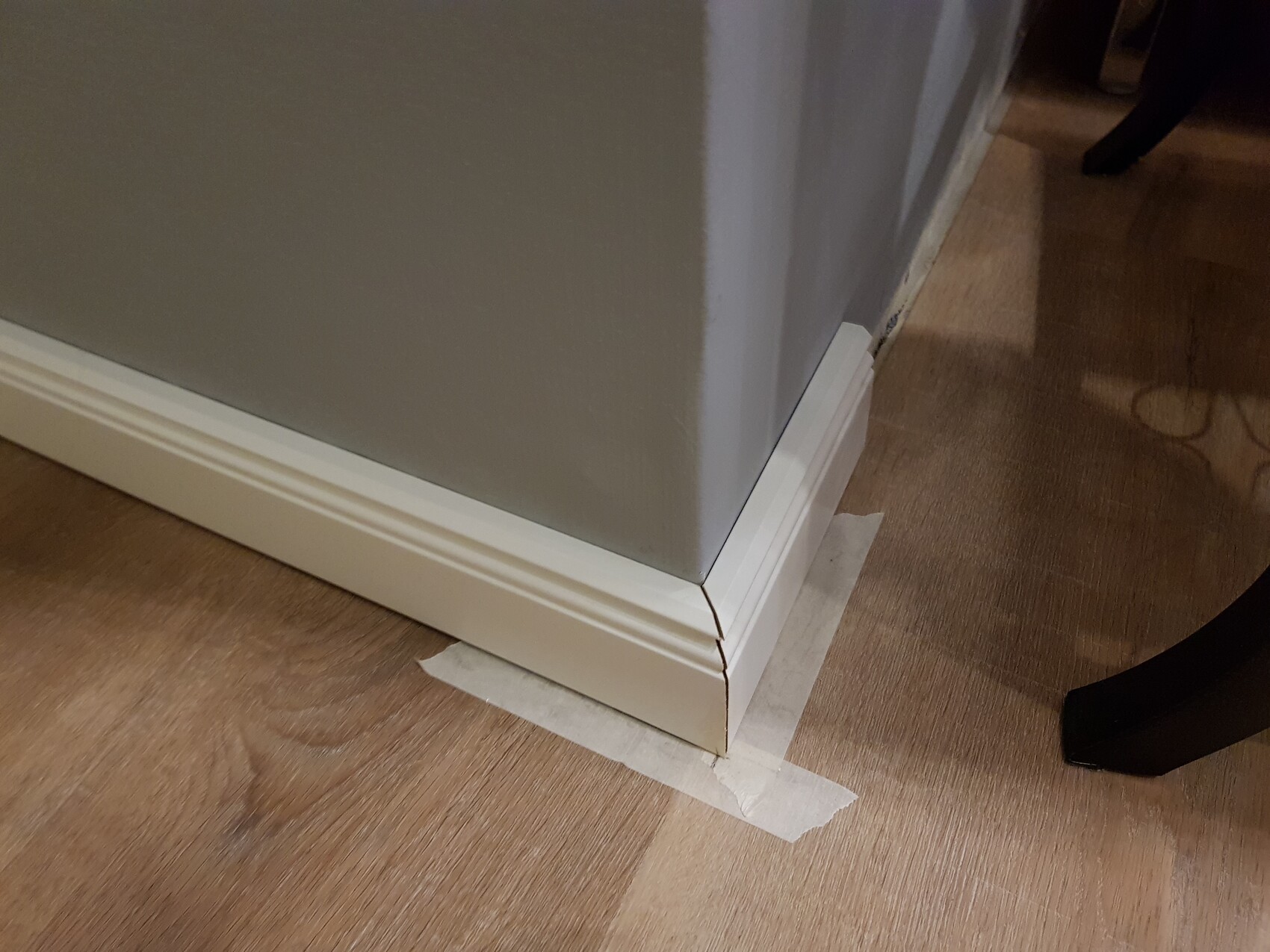

Okay, I took the advice here and just started. As expected, the first two corners look pretty terrible.
I haven’t glued anything yet. At the moment, I’m still torn between “redoing it” and “just gluing it and filling the holes with acrylic!”

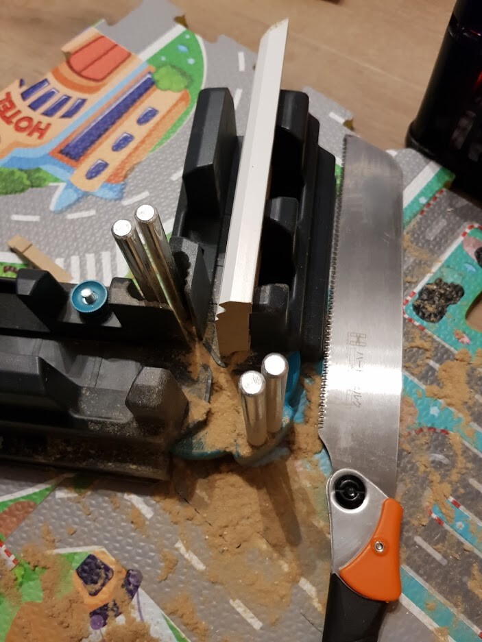

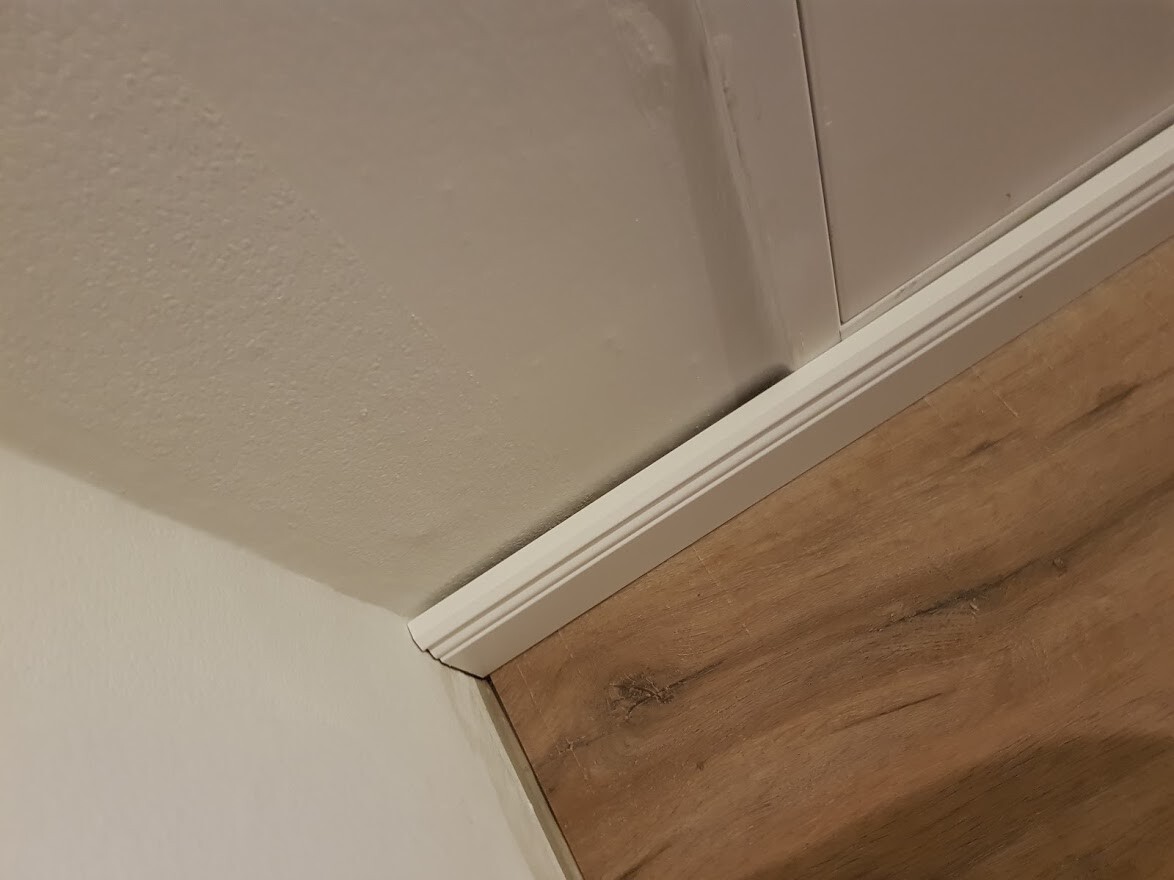

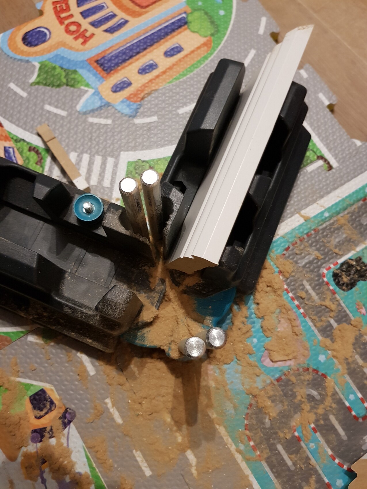

The inside corner (first attempt) looks really bad. I think my issue was that the angle changes depending on how the board lies in the cutting jig.
Close-up of a toy tool with dust and two metal rods
Work surface with saw guide: handsaw with orange handle, metal pins in holder and wood block, sawdust.
If the board is tilted inside the jig like in the photo, the miter angle comes out very odd.
When I manage to keep it reasonably straight—meaning pressing the board against the back wall of the jig—the angle improves a bit (see outside corner).
Now I don’t know, is there a trick to reliably fix it so it stands straight and the cut comes out clean?
Holding the board by hand causes quite a bit of muscle strain (and I’ve only made 4-5 cuts so far), plus the result isn’t perfect.
Another problem is that this cutting jig has a certain height, and when I put a long molding strip in it, the back of the strip naturally rests on the floor, making it stand higher inside the jig. I try to fix this by placing foam underneath at the back to roughly match the jig’s height, so the molding lies more level horizontally. But of course, this isn’t exact when I just slide in three foam pads, which probably leads to inaccurate results.
Can I do better with my angle tool and Japanese pull saw? Or is a compound miter saw inevitable?

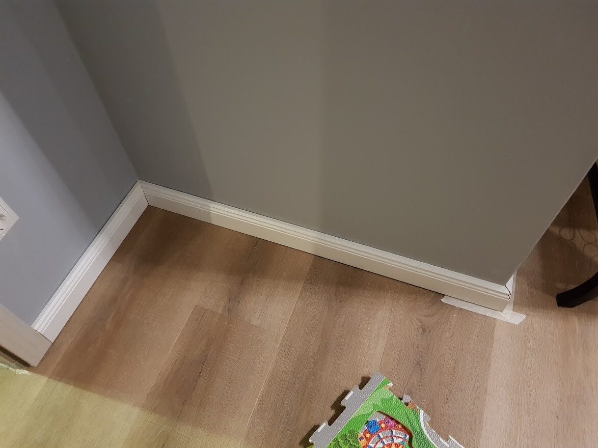

This one was just cut. It was the first one. It’s a bit tight (slightly oversized), but overall, it turned out pretty well. Still not glued—I’m not brave enough yet.
Corner room with gray walls, white skirting board, wooden floor; play mat in the lower right corner.
Looking at this photo, I think “hmm, despite my rough corners it doesn’t look too bad”… maybe because I had seen it for so long without any baseboards, and well, anything is better than none. 😉

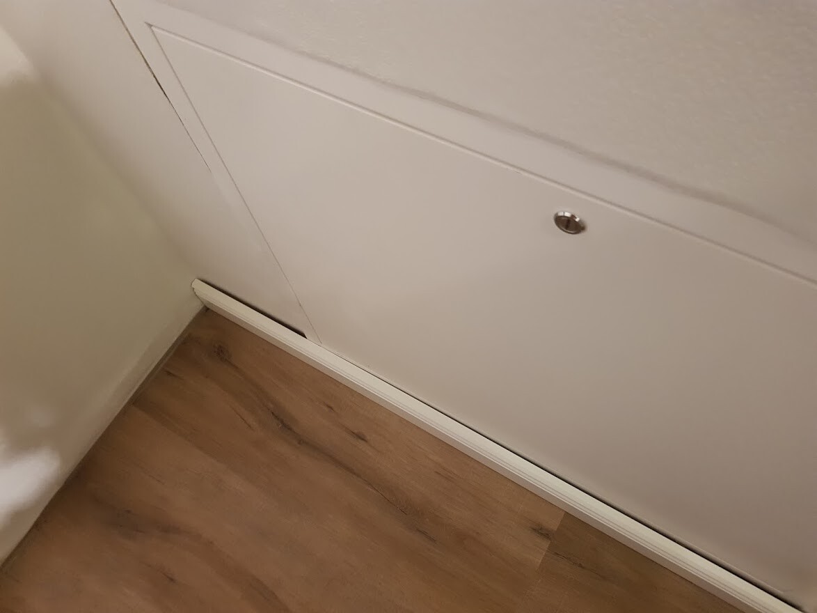

Then I ran into another issue in our hallway. This is the heating circuit distributor. How would you solve this? The metal box sticks out, but only on the left side. If I hold a molding strip in front of it, there’s a 5-10mm (0.2-0.4 inch) gap. How can I elegantly get around the corner there? :/
Bookstar
23 Jan 2021 20:52
You simply cut out the molding around the heating valve. You can use a multitool or a router. If necessary, a saw and chisel will also work.
Nordlys
23 Jan 2021 20:57
That works. A bit of white acrylic covers a lot. Just don’t be discouraged, keep going. Practice makes it better. A floor lamp or a rubber plant will go in the corner with the acrylic, and that will look good.
