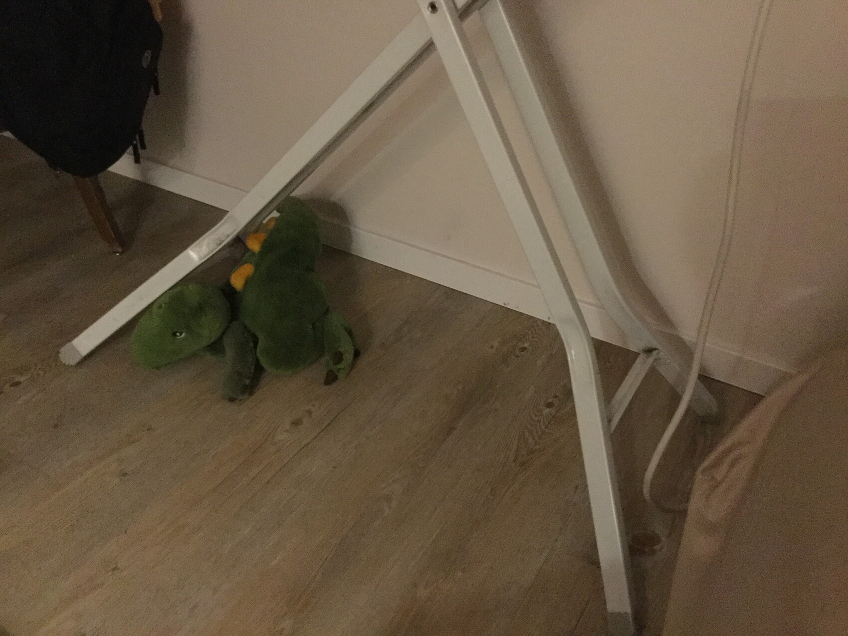

Wet rooms should have a tile baseboard if they are genuinely damp. Bathrooms and possibly the utility room. For me, the kitchen is not a wet room.
Our baseboards are also made of MDF.
Grüner Plüsch-Dino mit orange Streifen liegt unter einem weißen Klapptisch auf Holzboden.

Yes, this is exactly what we are looking for. Can someone without professional experience handle the corners properly? The tool I saw is placed on the respective corner to set the angle for cutting. It sounds simple at first.
