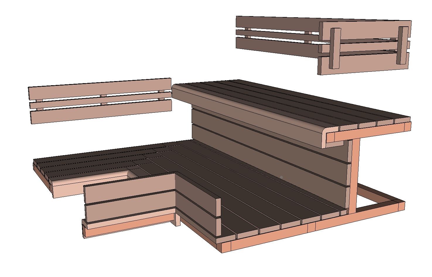

For this reason, we planned the backrest on the left side. This is also where people usually sit, as it is the only spot with a view outside.
The entire layout is, in a way, designed to combine this view with the spatial conditions.
We are still flexible regarding the height of the backrest. The seat height is 47.5cm (19 inches), which we found comfortable.
