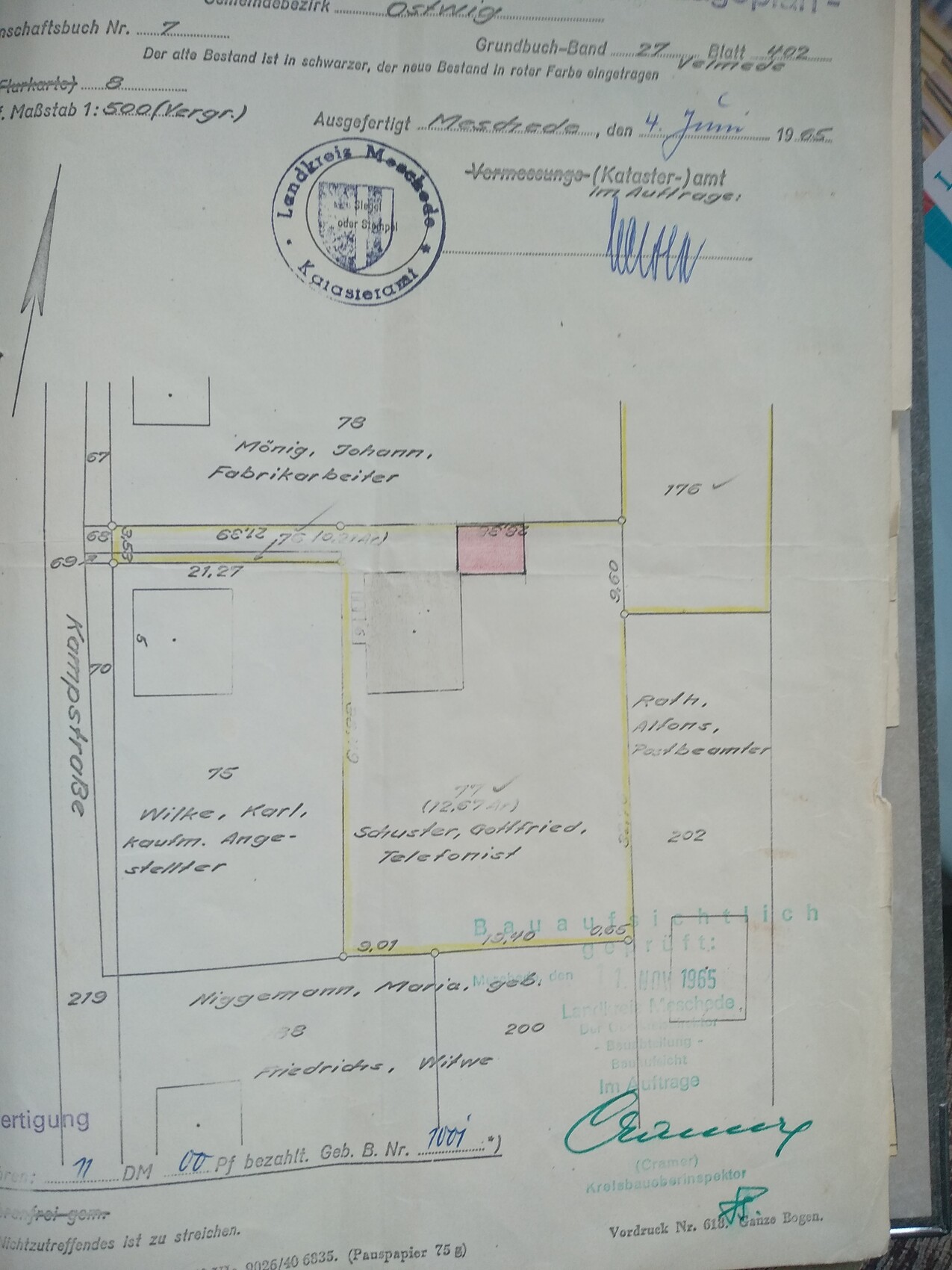

Unfortunately, I can't provide any input on the driveway, but the distance to the property boundary seems a bit narrow to me... Are you allowed to build that close to the boundary where you are?

I found this in our records; we only bought the house ourselves a few years ago. However, this plan does not show the houses currently existing on plots 176 and 202.
Historischer Katasterplan mit Stempeln, Unterschriften und Parzellenzahlen.

Escroda schrieb:
Maybe.
Is there a zoning plan / development plan?
Is the sketch at least roughly to scale?
If the answer to both is "no," please provide a generous section from the property map (tim-online).
Otherwise, show the zoning plan and mark the measurements on the sketch.
Have a look at §5 of the building code for NRW. The condition of the access depends on many factors. In my opinion, you will most likely have to give up the existing garage.

K.Schulte schrieb:
As far as I know, a 3-meter (10 feet) distance from the neighboring property must be maintained in NRW...

Even if we give up the garage, we would also have to demolish the garden shed in order to access the rear part of the property.
