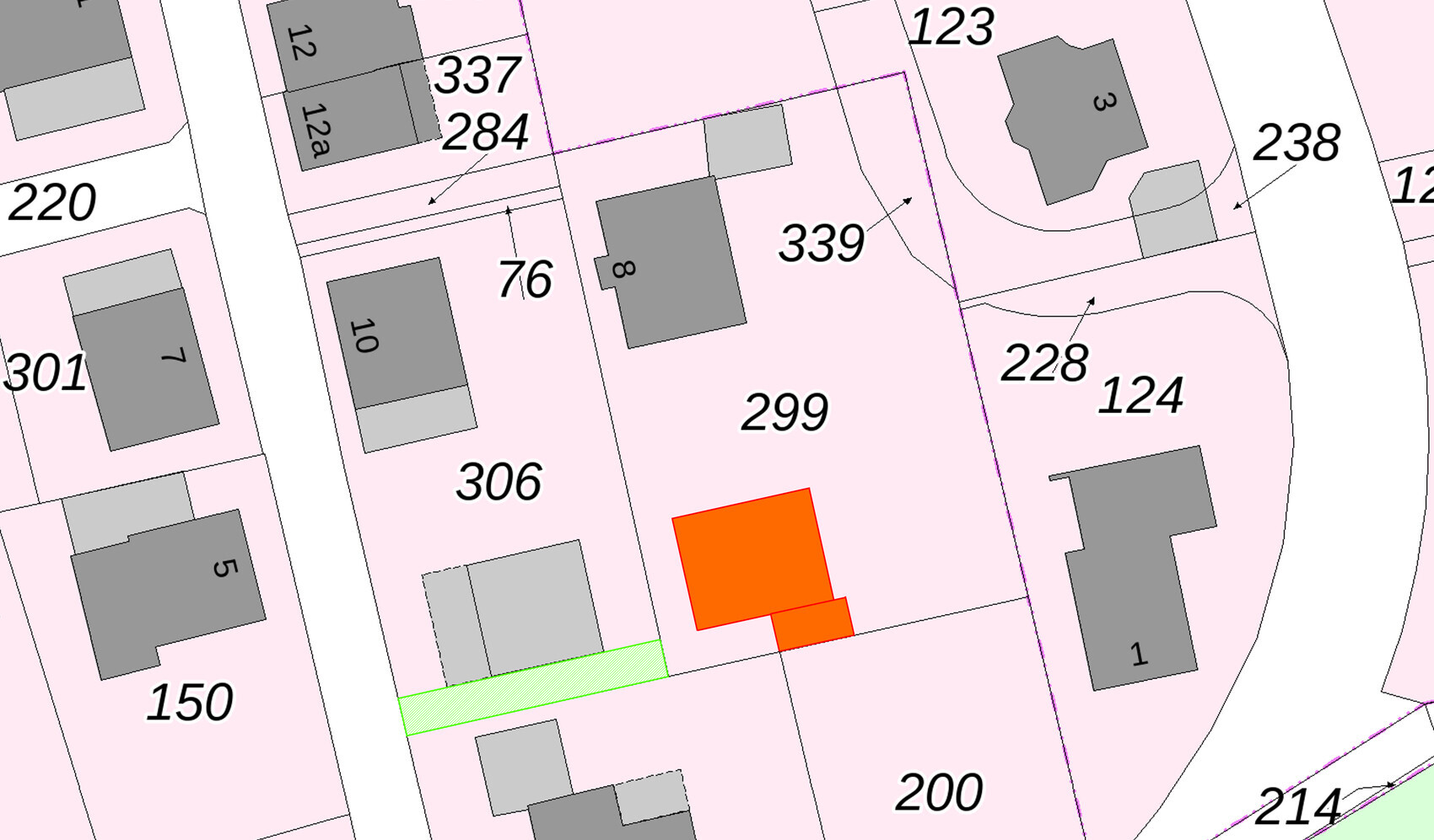

Unfortunately, I can't provide any input on the driveway, but the distance to the property boundary seems a bit narrow to me... Are you allowed to build that close to the boundary where you are?
Unfortunately, your municipality is not yet ready to publish the development plans online. If there is none, construction according to Section 34 of the Federal Building Code should be possible, but not as shown in your plan, since that would create a third row of buildings, which is usually not approved. Additionally, the existing building is positioned very unfavorably for using the current access road. However, you have three options to obtain access through neighboring properties, provided the neighbors agree. My preferred option with a construction easement (green) crosses plot 306:
K.Schulte1 May 2020 20:20Escroda schrieb:
Unfortunately, your municipality is not yet at the point of publishing the zoning plans online. If there is no zoning plan, construction should be possible according to Section 34 of the Federal Building Code, but not as shown in your plan, because this would create a third building row, which is usually not approved. Additionally, the existing building is positioned very unfavorably for using the current access road. However, you have three options to gain access through neighboring properties, provided the neighbors agree. My preferred option with an easement (green) over parcel 306:
