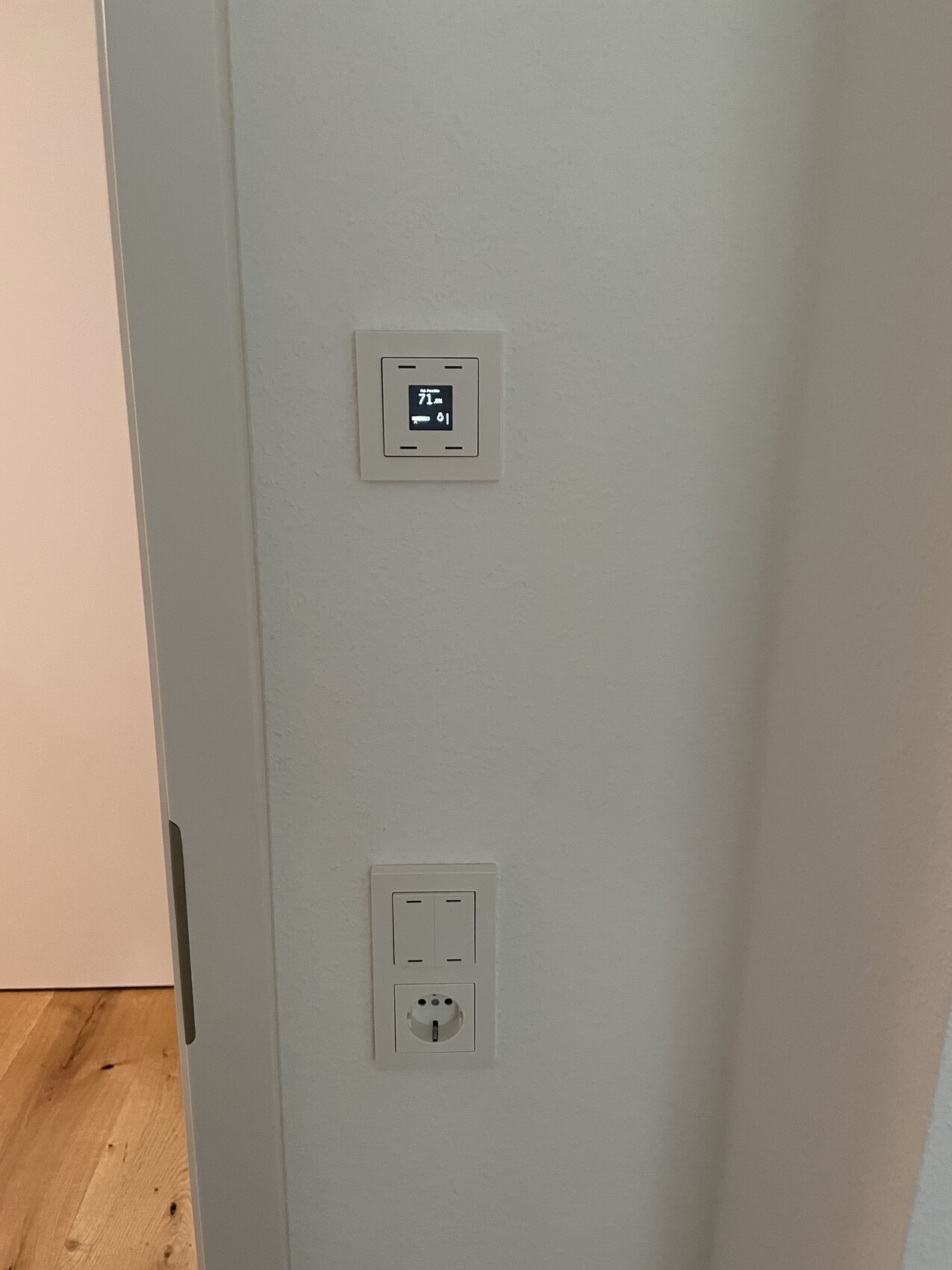

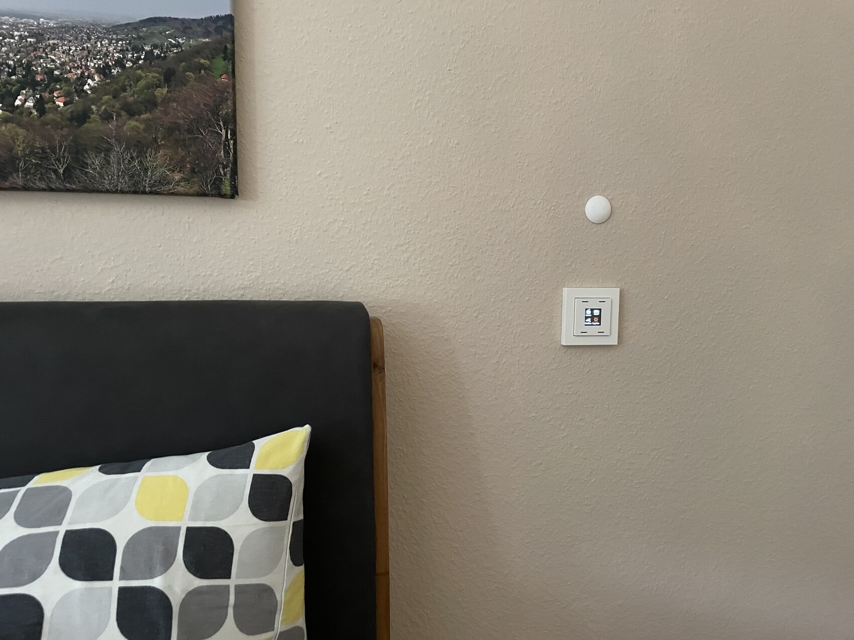

NoggerLoger3 Aug 2021 08:39Mouse piano on the wall? We were able to upgrade to KNX even in an apartment. Almost exclusively MDT devices were used. Wall-mounted push buttons with triple-click functionality theoretically allow me to control every light. However, most functions are automated or controlled via scenes. I had zero prior knowledge of KNX and only watched a few videos, but it’s really self-explanatory. In the living room, there is a control panel near the entrance and one push button; inside the living room itself, there are a total of two push buttons. The rest is managed through Steinel True Presence sensors or by power measurement at the stove. The rooms each have a double switch and one with a display. In the bathroom, the main and shower lighting turn off automatically thanks to two presence detectors.
No server was installed; everything is still integrated natively in KNX.
Furthermore, I had lamps installed that flickered slightly when dimmed by phase-cut dimming. I simply replaced the ballast with a DALI ballast, added a KNX gateway, and now I can dim them without PWM using amplitude dimming (no flickering, no tired eyes). Additionally, all the lamps are dimmed based on the time of day, preventing glare in the evening.
Nevertheless, the touch switches from Loxone are very attractive, but I wanted something tactile. Loxone has its justification and doesn’t pose high barriers for initial integration.
Here are a few photos of the “mouse piano.”
