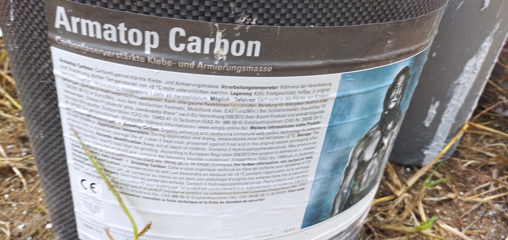

- According to the datasheet, it is green to brown when wet and black when dry. Do you like the black color?
- If I understand correctly, did you apply it directly onto the base coat (Armatop Carbon)?

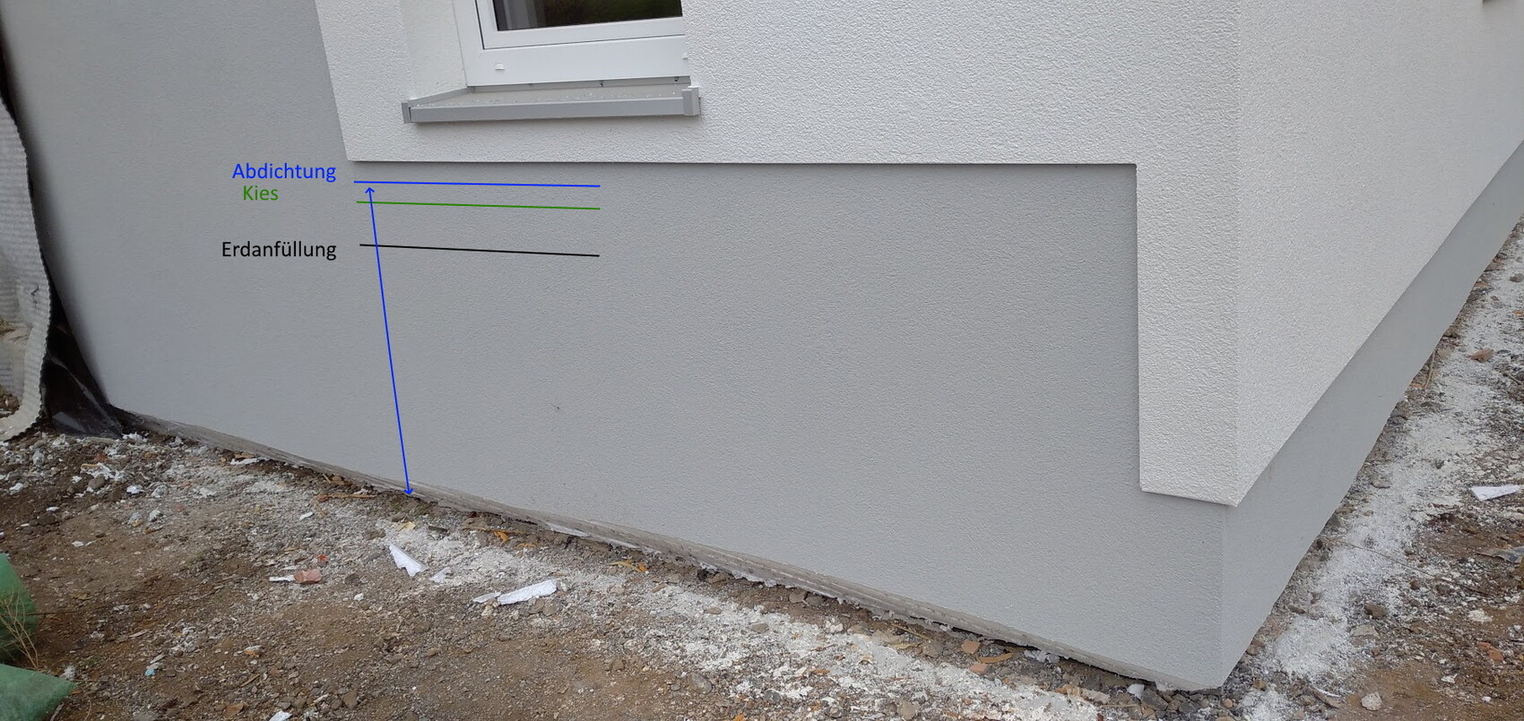

- I plan to coat the blue area. What do you think about that?
(The tapered insulation boards will still be skim-coated by the plasterer.)
- According to my calculation with two coats, we have 50m2 (540 ft2). According to Alsecco, one 25kg (55 lb) bucket covers exactly that. How many coats did you apply? I am considering just ordering two buckets (to be on the safe side).

fach1werk19 Nov 2020 21:04I also applied only two well-dried coats. They were applied directly onto the pigmented base render.
No, I didn’t find the black paint aesthetically pleasing. However, it can be covered with a paint matching the color of the base render.
I set the height a few centimeters above the splash guard. The splash guard is a gravel strip with a firm garden-side boundary. Our house is located on a level plot, so unfortunately I cannot offer an opinion on your blue area.
